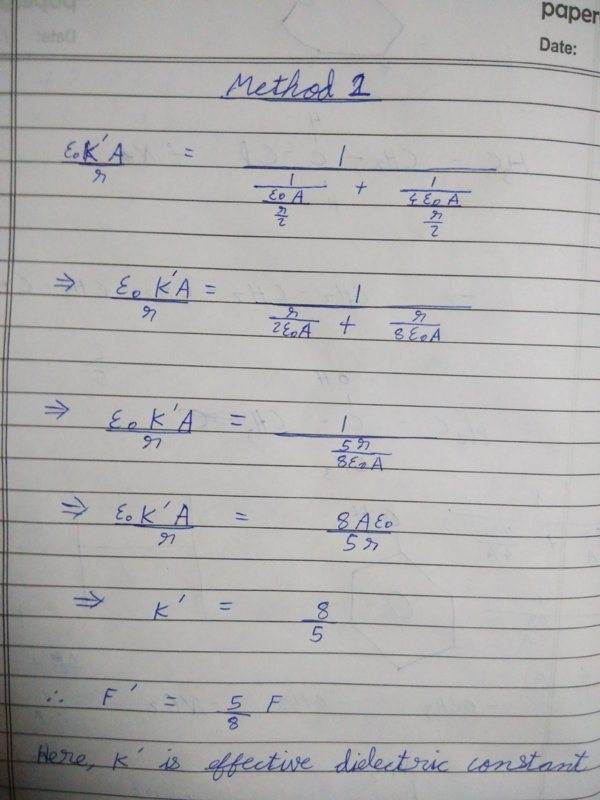

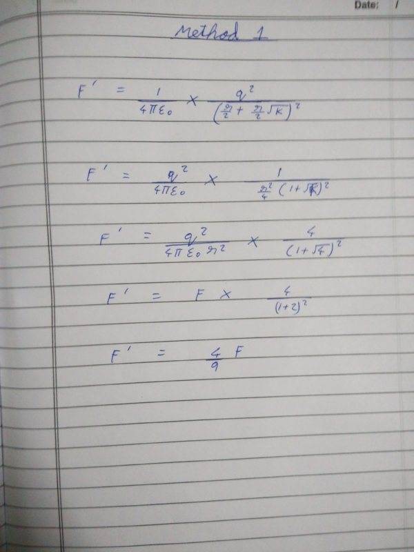

In summary, the force of repulsion between two identical point charges in air at a separation of r is F. When a dielectric slab with a dielectric constant of K=4 fills half of the gap between the charges, the new force of repulsion is either 4/9 *F or 5/8 *F, depending on the method used to solve the problem. While one method involves finding the effective distance between the charges using the formula r(effective) =r sqrt(K), the other method involves finding the effective capacitance of the two media by applying the formula for capacitors in series and using K=C'/C. The discrepancy between the two answers may suggest a flaw in one of the methods.
Prajwal
The force of repulsion between two identical point charges when kept with a separation r in air is F. Half the gap between the two charges is filled by a dielectric slab of dielectric constant K=4. What is the new force of repulsion between the two charges?
This is the question.
Now if I solve it by finding effective distance between the two charges(using the formula r(effective) =r sqrt(K)) ... I get answer as 4/9 *F.
But if I solve by finding effective capacitance of the two media (by applying formula for capacitors in series and finding effective capacitance by using K=C'/C).. I get the answer as 5/8 *F
Why am I getting different answers? Is there some flaw in my methods?
