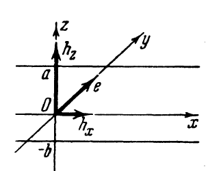

I'm reading a paper for a project. In the paper they derive an equation for the effective refractive index ##n=\sqrt{\epsilon^{e} \mu^{e}}## of two stacked layers ##(n_1^2 = \epsilon_1 \mu_1, a)## and ##(n_2^2 = \epsilon_2 \mu_2, b)## where ##a,b## are the lengths and in my case ##\mu_1=\mu_2=1##. One material is silica glass the other is air.
So using Maxwell's equations they derive this equation for ##n##: $$\frac{\alpha_2}{\mu_2} \tan\left(\frac{b\alpha_2}{2}\right)=\frac{\alpha_1}{\mu_1} \tan\left(\frac{a\alpha_1}{2}\right)$$
where ##\alpha_i=k\sqrt{n_i^2-n^2}=k\sqrt{\epsilon_i-\epsilon^{e}}##.
(I have attached a picture showing the setting used for the derivation.)

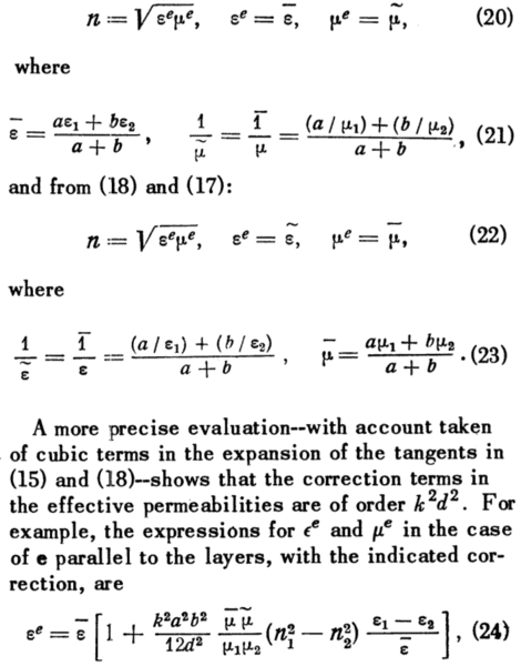

Here's my derivation: (I missed the minus sign in the original post)
\frac{\alpha_2}{\mu_2} \tan\left(\frac{b\alpha_2}{2}\right)=-\frac{\alpha_1}{\mu_1} \tan\left(\frac{a\alpha_1}{2}\right)
First I expand the tangents on both sides:
\frac{\alpha_2}{\mu_2}\left(\frac{b\alpha_2}{2}+\frac{1}{3}\left(\frac{b\alpha_2}{2}\right)^3\right)=-\frac{\alpha_1}{\mu_1}\left(\frac{a\alpha_1}{2}+\frac{1}{3}\left(\frac{a\alpha_1}{2}\right)^3\right)
Using the definition of ##\alpha_i=k\sqrt{\epsilon_i-n^2}=k\sqrt{\epsilon_i-\epsilon^{e}}## from the paper and setting ##\mu_1=\mu_2=1##:
b(\epsilon_2 -n^2) + \frac{1}{12} k^2b^3(\epsilon_2-n^2)^2=-a(\epsilon_1-n^2)-\frac{1}{12}k^2(\epsilon_1-n^2)^2a^3
Since ##n^2=\epsilon^e## and after ordering the terms according to the exponent of ##\epsilon^e## I get:
\frac{1}{12}k^2 (b^3+a^3){\epsilon^e }^2
-(b+a + \frac{1}{12} 2k^2 (\epsilon_2 b^3+\epsilon_1 a^3) )\epsilon^e +
(\epsilon_1 a + \epsilon_2 b + \frac{1}{12} k^2 (\epsilon_1^2 a^3 + \epsilon_2^2 b^3)) = 0
According to the section I attached a screenshot of from the paper this should be how the derivation is done.
But when I then substitute the values given in the OP and solve for ##\epsilon^e## I am not getting the same result as if I substitute them into ##
\epsilon^e = \frac{a\epsilon_1+b\epsilon_2}{a+b} + \frac{k^2b^2a^2}{12(a+b)^2}(\epsilon_1-\epsilon_2)^2

I don't think you should expand only the tangent. You have expressions that look like ##\alpha_i \tan\left(\frac{b\alpha_i}{2}\right)##. You should be expanding ##x\tan(cx)##. Note that this is an even function, so there are no odd order terms. It might be easier to do it this way and go up to sixth order for what you want to do.
On edit: I redid the algebra and I agree with your coefficients ##a_0,~a_1~##and ##a_2##. Now as you know these are the coefficients of a quadratic. The solution that is presented is probably an additional approximation to the exact solution of the quadratic because the quadratic does not look like a perfect square, so where is the radical? However, I am not sure I understand the physics of the situation well enough to figure out what the appropriate approximation is.
These equations are approximations that hold only if ##|\alpha_1 a| \ll 1## and ##|\alpha_2 b| \ll 1##. See the comments just above equation (20) in the paper. But your data doesn't appear to meet these conditions.
Likes AwesomeTrains
I ended up solving the equation numerically which gave me a pretty good fit to the measured values. The numerical solution works until approximately 500 GHz which is where the conditions from post #5 aren't holding anymore, so that is probably the explanation and then expanding to third order would probably not improve the result.
