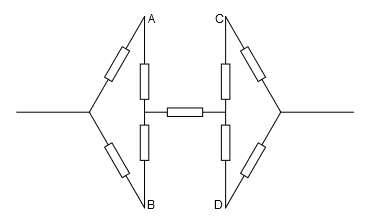

You are quite correct in observing that CD and EF have no potential difference. What about CE and DF?
As I have mentioned above, probably not clearly, I took into account that the resistance of CE and DF is simply sqrt(2)R/2 and R in parallel. This gives an effective resistance of sqrt(2)/(sqrt(2) + 2) across CE and DF
I am not entirely sure I understand what you mean by "effective resistance across CE and DF". Anyway, think about this.
Let's label the the inner square's vertices as A' (bottom left), G' (top left), B' (top right) and H' (bottom right).
Is there potential difference between A' and B'? Between G' and H'?
I meant that consider that between node C and node E is a parallel of circuit, by which one branch has a resistance of R while the other branch has a resistance of sqrt(2)R/2.
I'm sorry, by inner square do you mean the second largest square? or the largest square in black. If its the earlier, what do you mean by bottom left and top left. (Does bottom left refer to the point at D?)
I meant the biggest black square.
I would not think so since current does not flow in CD of EF?
A'G'B'H' and inner squares together are a conductor. Current can flow through it. So if there is a potential difference between A' and B' or between G' and H', it will.
But then assuming the current flows from A to B and CD and EF has no potential difference, how does the current get into the black square in the first place?
Look at this circuit.
Would current flow through its extreme left to its extreme right (or vice versa)?
Observe there is no potential difference between A and B, nor between C and D.
