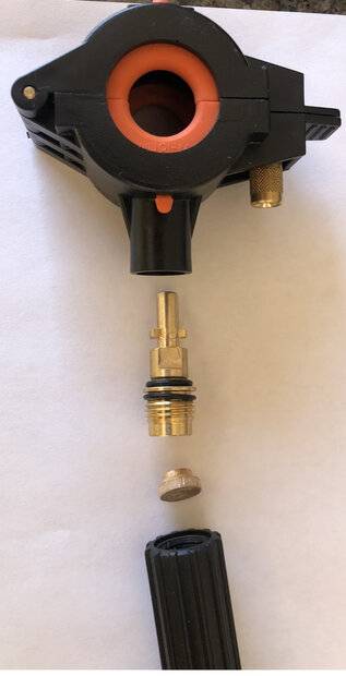

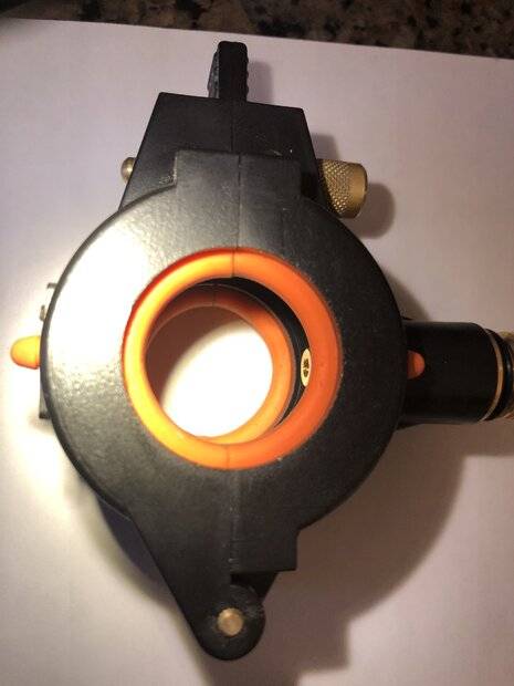

I’m a contractor using liquid CO2 (LCO2) to freeze water pipes (for valve maintenance) while the water service remains at full static pressure (i.e., water is not flowing).
I do the work in two locations: (1) near Denver, CO, where the altitude is 5,300 feet and (2) near Detroit, MI where the altitude is 1,000ft. Interestingly, I’ve found it takes WAY MORE LCO2 to do the same work in Denver than Detroit. At this point, I don’t have any data collected (i.e., water temp, ambient temp, etc.), so initially I’m looking at things theoretically with anecdotal observations.
My question here is: Assuming exact same situations (i.e., same copper pipe material, same size, same potable water temperature, etc.), how could one calculate and/or quantify the effects of altitude on LCO2 utilization? In other words, given the exact same work but at two materially-different altitudes, how many fewer pipes would be expected to be frozen with the same volume of LCO2 (e.g., standard 20-lb cylinder) in Denver vs. Detroit?
The last freeze in Detroit was a 1-inch type-M copper pipe, and it took 10-minutes (note: consistent with manufacturer’s specifications ) and used approximately 3-lbs of LCO2. The manufacturer of the freeze equipment does not provide adjustments for freeze times with higher altitudes, but I can state in Denver it seems to take a lot more time and use more LCO2.
Thank you in advance. -Mr. Freeze Miser

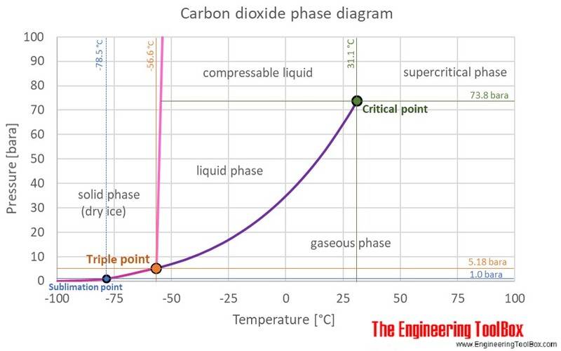

Please, see:
https://www.engineeringtoolbox.com/CO2-carbon-dioxide-properties-d_2017.html
https://homesteady.com/how-6514409-calculate-flow-based-differential-pressure.html
"The change in freezing point (water inside pipe if system is opened to atmosphere) at different altitudes is much smaller than the change in the boiling point (liquid CO2 expanding to atmospheric pressure).
The freezing point increases very slightly at higher altitudes, due to the air pressure. Because ice takes up more space than water, a lower air pressure will cause water to freeze at a slightly higher temperature."

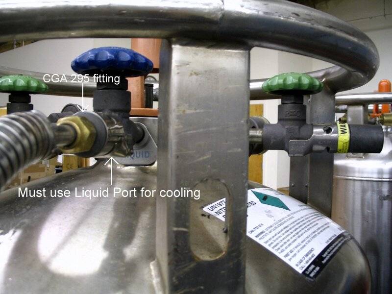

russ_watters said:
(Can CO2 even be liquid at atmospheric pressure?)
Yes, but not for long. Please don't ask me how I know this...
Broken LCO2 connection from a dewar that I had to deal with in the lab -- crazy.

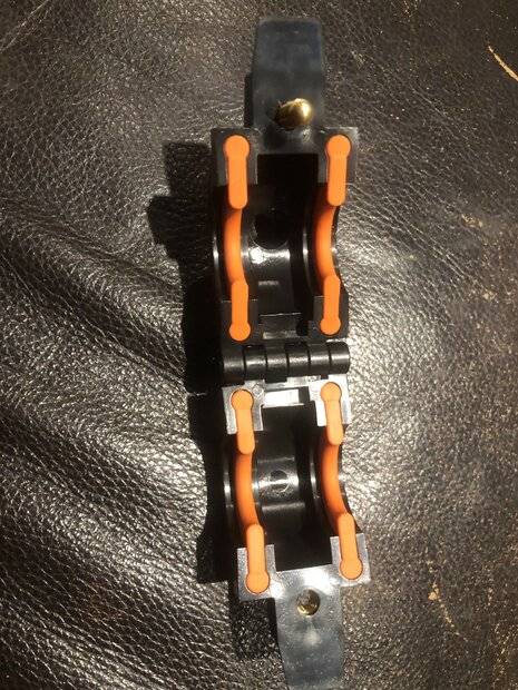

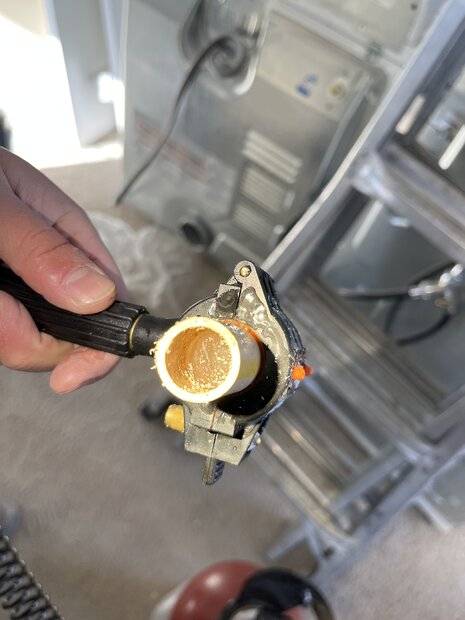

Thanks, Lnewqban. Yes, this is the system I’m using. I cross-sectioned an ice plug with 3/4” CPVC and was super impressed by the very dense ice…extremely robust.

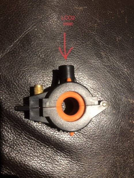

MrFreezeMiser said:

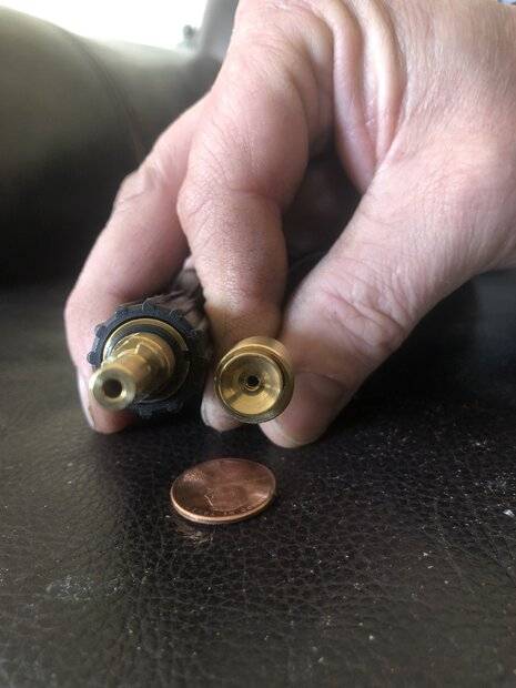

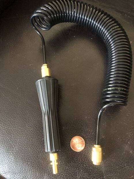

One other note is the tubing coming from the tank connection is like 1/8” OD. You’d think that would freeze solid and snap with LC02 going through it!
A misunderstanding.
Why should the tube 'freeze'?
The liquid CO2 in the bottle is at room temperature.
So is the liquid CO2 passing through the tube.

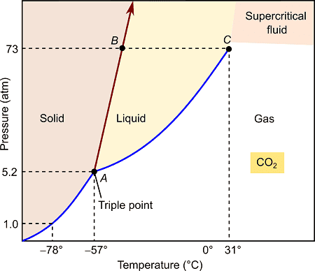

According to the phase diagram for CO2 presented in post #6, at -110 C, CO2 is a solid. The temperature must be >-55 C and the pressure in the tank must be above 5 bars absolute (4 bars gauge, 60 psig) for there to be liquid CO2 in the tank.
Here is a pressure-enthalpy diagram for CO2.
At -40 C (=-40 F), the pressure in the tank is going to be about 140 psi (125 psig), and the CO2 exiting that valve and tubing will be a mixture of about 45% CO2 vapor and 55% CO2 solid (assuming constant enthalpy through the valve and tube), down to 15 psia. The temperature of this mixture will easily be <-40C, and could easily approach -110 C. The final pressure (1 bar vs 0.85 bar) could effect the final mixture temperature by about 10C (say -120 C vs -110 C, according to the diagram). This should not substantially affect the freezing time of the pipe.
Likes 256bits, DaveE, MrFreezeMiser and 1 other person

Yes, I agree it shouldn’t freeze. It’s just me and kind of like my response to a magic trick…it should, but it doesn’t.

Unfortunately, the manufacturer doesn’t include a pressure gauge, but maybe I can get the data or see if the supplier can tell us. I have refrigeration pressure gauges that go to 800-psi, but now that you‘re suggesting it might be 800-psi or more, I might have to buy a higher limit gauge for testing. I have two tanks to refill in Denver, so I could get pressure at temperature from these close-to-empty tanks. Then when I get replacement tanks (supplier just swaps them), I could gather that data as well and post it.
Interestingly, today I tried to freeze 3/4” CPVC when the ambient temperature was approx 20ºF. I brought a full tank that was kept on the truck on it’s been like -5ºF here, so I bet the tank was somewhere around this temperature. As ironic as it sounds, yes, I was freezing pipes in freezing cold weather. And here I wanted to see what would happen in ambient conditions. My guess was just gas would come out based upon what I’ve learned from folks here. So after hooking up everything, yep, LCO2 would not flow. Only gas hissed like you hear when the LCO2 tank is close to empty. So I took one of our portable heaters and warmed up the tank really good [read: hot], and like magic, LCO2 began to flow like normal.
Typically, we freeze 3/4” CPVC for 20-minutes in Denver (no data for Detroit). Today, I did 25-mins—just to be certain—and it worked perfectly with pre-heated tank and maintaining heat throughout the process. But I bet I used a lot of that brand new 20-lb cylinder. These jobs are critical and consuming, so I forget to gather data to stay focused. I need to do better with this.

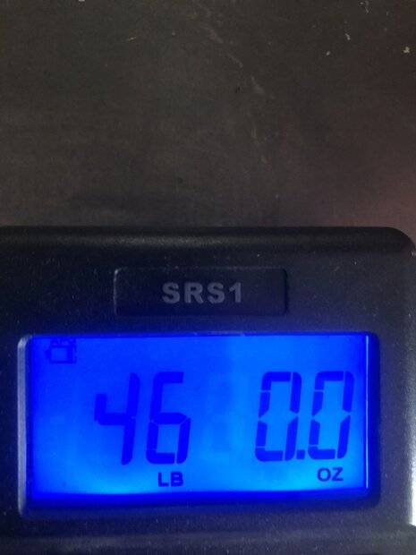

Supposedly cylinders are full with 20-lbs of LCO2 from the supplier. When I get replacements, I’ll get actual net weight(s). My guess is it’ll be 20-lbs or slightly over.

Weighed the two new 20-lb cylinders. First one was spot on 20-lbs net LCO2. Second was short by 1.7 ozs (only posted pics of 1st cylinder).

Some other notes: Local supplier didn’t have any ideas/recommendations for a LCO2 flow regulator. I told him a pressure regulator wouldn’t work anyway because we still need high pressure just at a lower, adjustable flow rate. Harris makes some flow regulators—use them in various welding processes—but I will have to contact it to be sure it would fit this tank [valve] style and is designed to be used safely with LCO2.
Supplier didn’t offer a blanket heater to keep tank warm, but pointed me to the web. Said the tank is rated for 1,800 PSI. He didn’t know the blow-off relief pressure, but said last summer a 5-lb released sitting in the sun on a hot day.😳 And once the relief pops, it empties.
