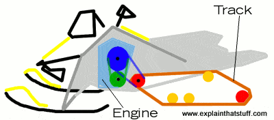

I have a quick question that I think has a simple answer. On a snowmobile forum I visit there has an ongoing debate. The question is, all other factors being the same, does changing the lug height on a track, change the final drive ratio of the snowmobile? I think I know the answer but articulaying it correctly is difficult.
If you're driving on pavement, sure. The tips of the lugs, in contact with the pavement, are at a larger radius from the driving axle.
If you are on snow, my opinion would be "probably a little bit." It would depend on where the effective center of force occurs on the snow-lug interface. If you are on hardpack riding on the lug tips, it would be the same as driving on pavement.
On light, fluffy stuff I would expect the center of drive force to be anywhere from half way along the lug depth up to the body of the track. With the result that you would get between one half the expected drive ratio increase to no change at all.
In the real world you probably wouldn't notice the difference. When you take into account the radius of the drive pulley plus the track thickness and lug depth, adding a little to the lug depth is going to be a small percentage change.

The speed of the drive wheel over the track will be the same as the speed of the vehicle over the ground (with no slip, the parts of the track in contact with the ground will be stationary relative to the ground). So I reckon that the only thing that governs the ratio is the radius of the drive. The thickness of the track may help or hinder the grip but, if there's no slip, it can't affect the ratio because there is no 'rotation' of the bottom section of the track (I assume).
The actual length of the track is irrelevant to the ratio because the only bit of track that's transferring drive to the ground is the horizontal bit. It's the equivalent of driving over a strip of track that's been laid over the snow (basically). The details of which bits of the track are actually pushed against by the drive wheel in only relevant in as far as where the teeth of the drive wheel actually bear on the links of the track (i.e. deep into the teeth or near the tips) but I guess the wheel and track are always matched. The ratio depends on the number of teeth on the drive. Each rev will push you forward by the number of teeth times the pitch of the track.

Note: If you want to specify the 'gear ratio' for a system with a linear drive (i.e. a track), you can't express it as n:m where n and m are turns of a shaft. You have to specify it in terms of turns of the input shaft for a given linear distance.

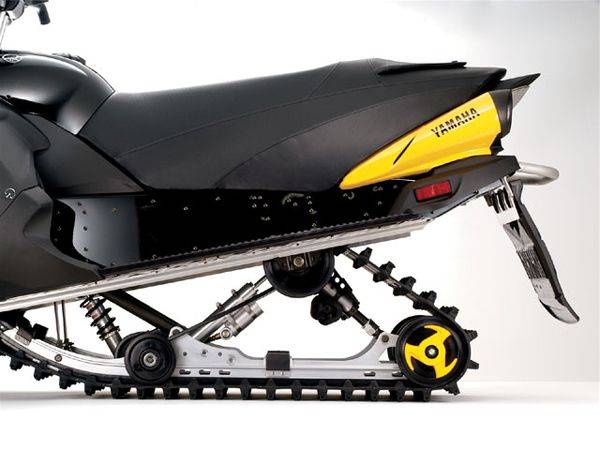

Look at where the center of the drive sprocket axle is in relation to the surface of the track. You can calculate the tangential velocity (essentially vehicle speed if you ignore track-to-road slip) of any point from the axle out. The tangential velocity is the rate of rotation times the radius from center of rotation. So for a given RPM the tangential velocity increases as the radius increases. If the surface of the track gets farther from the axle (thicker track) then the tangential velocity increases. Increasing tangential velocity relative to engine speed says the drive ratio has changed. It's just like putting larger diameter wheels and tires on a car, the vehicle will travel farther per axle revolution.

Ok, let's have a look:
Looks like the drive sprocket is nowhere near the ground.

What is this radius, for the straight part of the track that contacts with the road? Where is the center of rotation for that linearly moving part of the track?

As far as I can see, where it is in contact with the road (where it counts) the top and bottom surfaces of the track are moving at the same speed. The periphery of the drive wheel is the thing that sets the speed of the inner part of the track that it's in contact with it. If the inner part of the track does not compress or stretch then that is what determines the speed of inner and outer surfaces on the straight section, in contact with the road. The pictures of tracks (Google has dozens and dozens of them) seem to have a continuous inner belt, in contact with the drive wheel and any added thickness of track consists of articulated transverse treads. These treads radiate outwards when going around a curve or drive wheel but are parallel along the straight section. So the distance per drive wheel rev is independent of the thickness of the track.
I can see that an alternative design of track could change things - for instance if the inner surface of the track had teeth that compress longitudinally as they go over a wheel - but I don't think that is the case on a snowmobile.

Of course I agree with that but the speed over the ground is not the tangential velocity of the end of the lugs.
As I have already said, the "final drive ratio", stated in terms of wheel diameter (or gear teeth) is not so relevant as the linear distance per rev. Think about what happens to the lugs as they go round the rear (idler) wheel. They are stationary on the ground and so is the inner 'belt'. As they lift off the ground they start to rotate and end up going vertically, then forward and over the top of the wheel. On the way round the wheel, because they lie radially, they go faster than the belt but then they slow down again on the upper straight section and have the same speed as the belt. This applies whenever the belt goes over a wheel. So the effective drive 'ratio' depends on the diameter of the drive wheel and its peripheral speed.
This is not intuitive, I can see, but it's the right argument and drawing it out for yourself could help you 'justify' it. :smile:
BTW, although the track is stationary when it's on the ground, the velocity relative to the vehicle is what counts and that is equal and opposite to the velocity of the vehicle over the ground.
