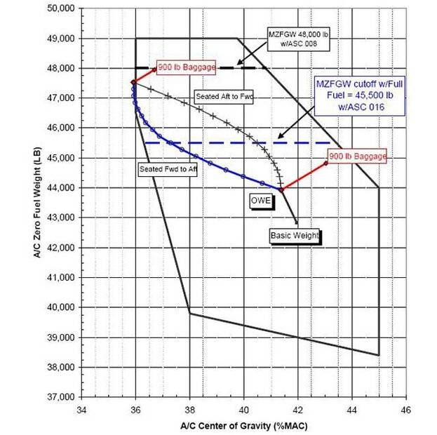

As Russ has already mentioned, you need to stay within the CG envelope. In essence, you don't want things to get to the point where control surfaces are not capable of achieving the correct pitch for the aircraft( especially during times like take-off and landing).
It is also important to work things out for both fuel load at take off and fuel load when reaching one's destination. For example, let's say you are in a small aircraft with passengers and luggage in the rear. You work out your CG while fully fueled and it works out okay.
When you get to your destination, you've used a considerable amount of your fuel load. Now it isn't any shift in fuel weight position that is the issue, it is that the plane is lighter as a whole and your rear passengers and luggage now make up a greater percentage of the craft's weight, causing the CG to shift to the rear. To much of a shift, and you may not be able to hold the right angle of attack and stall during landing.
You'd use a chart something like this:
