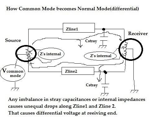

Great answer, Tom. Here's where I'm getting lost. Why is "shielding" important for a balanced line? Are not all transient signals eliminated when both signals are combined at the end of the signal chain? Am I simply expecting theoretical results in a non-theoretical world? I'm thinking: (Signal + Noise) - (-Signal + Noise) = 2xSignal.
Shielding reduces currents induced into signal lines from external sources.
In a perfectly balanced system you're right, they'd cancel and that's why balanced works so well .
In the real world there's always some unbalance and that's what turns common mode interference (into both wires equal and in phase)
into normal mode interference(unequal in the two wires so looks just like signal) .
Are internal Z's perfectly balanced ? How about stray capacitances ?
Minimize induced currents and you reduce their effect through unbalanced Z's.
A high quality instrument system will specify along with its common mode rejection ratio just how much unbalance it will tolerate and still perform within that spec.
My old plant computer system's "front end" specified 140db with 1Kohm unbalance
which was stellar for 1973 and is pretty doggone good today.
