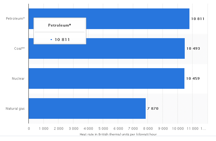

https://www.statista.com/statistics/186397/average-operating-heat-rates-by-source-in-the-us/
2016 statistics :

gmax137 said:
Btu/MWe
jim hardy said:
Heat Rate is BTU/KWh , energy /energy
not BTU/MWe which is energy/power
thanks old jim, you are of course quite right! Sorry for the brainfart.
