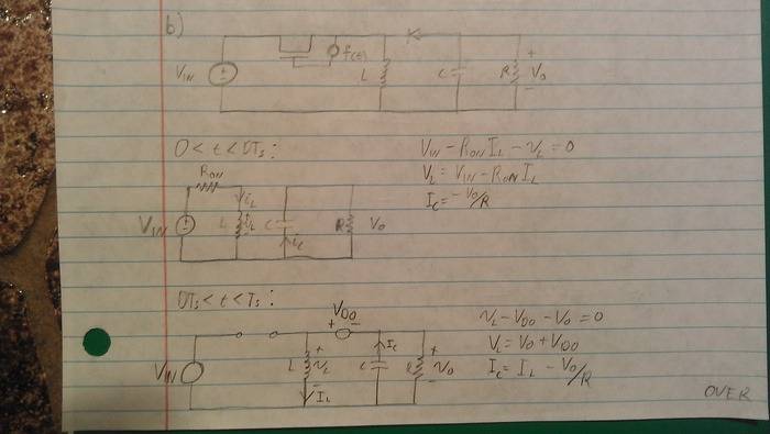

In summary, the Buck-Boost converter has two modes, one where the transistor on resistance (R_{ON}), the converter diode, and the load have voltage drops, and one where they don't. The efficiency is 100% when R_{ON} and V_{D_0} are set to 0.
Captain1024
45
Consider a Buck-Boost converter. If in addition to the transistor on resistance [itex](R_{ON})[/itex], the converter diode has a voltage drop [itex](V_{D_0})[/itex], symbolically derive an expression for the efficiency, η of the converter, where η = 100* PO/PIN. Verify that that when [itex]R_{ON}[/itex] and [itex]V_{D_0}[/itex] are set to 0, the efficiency is 100%.
[itex]<V_L>=0[/itex]
[itex]<I_C>=0[/itex]
[itex]D'=(1-D)[/itex], where D is the duty cycle
Analysis of the two modes of Buck-Boost converter:
When [itex]<V_L>=0[/itex]
[itex]\frac{DT_s(V_{IN}-R_{ON}I_L)+D'T_s(V_O+V_{D_0})}{T_s}=0[/itex]
Equation 1: [itex]DV_{IN}-DR_{ON}I_L+D'V_O+D'V_{D_0}[/itex]
When [itex]<I_C>=0[/itex]
[itex]\frac{DT_s(\frac{-V_O}{R})+D'T_s(I_L-\frac{-V_O}{R})}{T_s}=0[/itex]
[itex]-D\frac{V_O}{R}+D'I_L-D'\frac{V_O}{R}=0=\frac{-V_O}{R}+D'I_L[/itex]
Equation 2: [itex]I_L=\frac{V_O}{D'R}[/itex]
Plug 1 into 2:
Equation 3: [itex]V_O=\frac{DV_{IN}+D'V_{D_0}}{\frac{DR_{ON}}{D'R}-D'}[/itex]
Equation 4: [itex]P_{IN}=V_{IN}*I_{IN}=V_{IN}*I_L=V_{IN}\frac{V_O}{D'R}=\frac{V_{IN}(DV_{IN}+D'V_{D_0})}{D'R(\frac{DR_{ON}}{D'R}-D')}[/itex]
Equation 5: [itex]P_O=\frac{V_O^2}{R}=\frac{(DV_{IN}+D'V_{D_0})^2}{R(\frac{DR_{ON}}{D'R}-D')^2}[/itex]
Dividing equation 5 by Equation 4 yields Equation 6: [itex]\frac{D'(DV_{IN}+D'V_{D_0})}{V_{IN}(\frac{DR_{ON}}{D'R}-D')}[/itex]
Setting [itex]R_{ON}=0[/itex] and [itex]V_{D_0}=0[/itex] in Equation 6 yields: [itex]\frac{D'(DV_{IN})}{-D'V_{IN}}[/itex]
I need Equation 6 to equal 1 when [itex]R_{ON}[/itex] and [itex]V_{D_0}[/itex] are set to 0.
Im having trouble following your thought process.
I would go about it a different way.
eff = 100 * Po / Pin
So derive an expression for Po and Pin.
since Roff is inf, you can assume no current is transferred during the off state of the transistor. So use your duty cycle to determine the current. P=IV so you now should have an expression for input power.
As you stated earlier the inductor voltage and capacitor current averages will be zero. You can use this to derive an expression for your output power. You will then see that setting Vdo and Ro to zero will cause Po=Pin
You show the output as + but I assume you know the output will be -.
If you want I'm willing to do the problem and compare answers if you manage to get an expression that = 100% when Ron and Vd are both zero.
I figured out my mistake. My line for Equation 4 should say [itex]P_{IN}=V_{IN}*DI_L=...[/itex]
After that it worked out.
