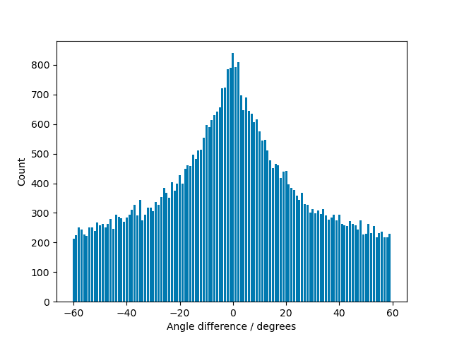

##L_1 = 0.672##, ##\theta_1 = 353^\circ##, ##L_2 = 0.614##, ##\theta_2=128^\circ##.
Your method gives ##\theta_t## about ##-114^\circ## instead of ##54^\circ## and ##L_t## about ##-0.485## instead of ##0.495##.
There are worse cases (that one is only about 2% off on the magnitude, ignoring sign), but that one came up fairly quickly.
Likes Vanadium 50
Here's the distribution of differences between your method and the full calculation when you add two random vectors 100,000 times:
And if you add ten random vectors 100,000 times:
Likes Vanadium 50

my angle formula only works if every instance of ##L_n## is the same, because the longer ##L_n## is the more disproportionately it's pairing ##\theta_n## matters so yes my angle forumla is not finished, it can't be used outside of very specific situations, I wish to expand it's reach
Ibix said:
You'll need to use ##\sin## functions at least, so it'll be at most as efficient as the usual method.
I do suspect that sin function will be needed of the angle formula, just don't know where and if it'll be the only thing needed to be added
I do not think you can expect us to correct your formula, and make it reliable. If we did, then it would be slower than the standard vector addition algorithm.
CPUs now generate both the sin() and cos() of an angle at the same time in parallel. You have replaced three sin() functions with several divisions.
Vector computation is "well trodden ground". A number of clever ways to speed up other numerical vector operations have been found, and are used. If there was a way to speed vector addition, then I think it would have been found and widely publicised during the last 100 years. By all means, keep searching, and let everyone know if you find a reliable solution.
