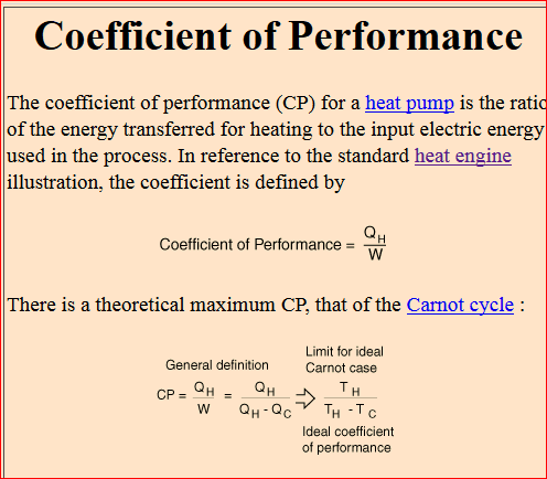

If he could cool the exit stream to let's just say 5C
he'd extract most of his heat need from it
what is Carnot limit for heat pump operating between 5C and 15C ?
http://hyperphysics.phy-astr.gsu.edu/hbase/thermo/heaeng.html#c3
do i remember correctly
15C = 288 K
5C=278K
CP = 288/(288-278) 288/10 = 28.8
this is where heat pumps shine, low temperature difference
When used for heating a building with an outside temperature of, for example, 10 °C, a typical air-source heat pump (ASHP) has a COP of 3 to 4, whereas an electrical resistance heater has a COP of 1.0. That is, one joule of electrical energy will cause a resistance heater to produce only one joule of useful heat, while under ideal conditions, one joule of electrical energy can cause a heat pump to move three or four joules of heat from a cooler place to a warmer place. Note that an air source heat pump is more efficient in hotter climates than cooler ones, so when the weather is much warmer the unit will perform with a higher COP (as it has a smaller temperature gap to bridge). When there is a wide temperature differential between the hot and cold reservoirs, the COP is lower (worse). In extreme cold weather the COP will go down to 1.0.
https://en.wikipedia.org/wiki/Heat_pump
If he could actually get a CP of 3
would his 2 mw drop to 2/3 = ~0,7 mw?
At 10 cents a kwh that's $130 an hour !
