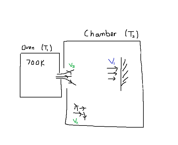

Part (a)
Letting ##\phi## be flux, and ##\Delta p## be change in momentum of rebounding molecule,
[tex]\phi \Delta p = \left(\frac{4}{3}\pi r^3\right)\rho g[/tex]
[tex]\phi (2m\overline c) = \left(\frac{4}{3}\pi r^3\right)\rho g[/tex]
[tex]R = \frac{2}{3}\frac{r\rho g}{m \overline c}[/tex]
Funny how the mass of the molecule is not given. But this make sense as the more massive the atom traveling at a certain speed, the less flux you need to support the weight.
Part (b)
The speed distribution of molecules coming out of the oven is given by ##f = 2\alpha^2 v^3 e^{-\alpha v^2}##.
[tex]v_2 = \int_0^{\infty} v f dv[/tex]
[tex]= \frac{3}{4}\sqrt{\frac{\pi}{\alpha}}[/tex]
[tex]= \sqrt{\frac{9}{8}\frac{\pi kT_1}{m}}[/tex]
For interest, let's calculate the temperature of the Chamber:
[tex]v_2 = \sqrt{\frac{8kT_2}{\pi m}} = \sqrt{\frac{9}{8}\frac{\pi kT_1}{m}}[/tex]
[tex]T_2 = \left(\frac{3}{8}\pi\right)^2 T_1\approx 972K[/tex]
To calculate ##v_1##, we use the speed distribution of the chamber (not the one coming out of the oven!)
[tex]g = 2\alpha_2^2 v^3 exp(-\alpha_2 v^2)[/tex]
[tex]v_1 = 2\alpha_2^2 \int_0^{\infty} v^4 exp(-\alpha_2 v^2)[/tex]
[tex] = \sqrt{\frac{9}{8}\frac{\pi kT_2}{m}}[/tex]
[tex] = \pi \sqrt{\frac{81}{512}\frac{\pi k T_1}{m}} \approx 1112 ms^{-1}[/tex]
Part (c)
I'm not sure whether the mean free path calculated here is correct.
The relative speed is ##v_r = |v_2 - v_1| = 1112 - 944 = 168 ms^{-1}## and ##n = \frac{P}{kT} = 2.47*10^{17}## and ##\sigma = 1.52*10^{-19}##.
Mean free path = (Distance travelled)/(No. of collisions during that distance)
[tex]\lambda = \frac{v_2t}{v_r n \sigma t} = 176m [/tex]
Part (d)
In this case, ##v_r = |1112 - 10| = 1102##.
[tex] \lambda = \frac{10t}{v_r n \sigma t} = 0.24 m[/tex]
This is roughly 700 times less than above.
This means that the atoms in the beam have a much larger mean free path than the atoms in the chamber. Thus velocity of the beam reduces much only after 176m into its flight path.
bumpp , anyone mind checking my answers?
