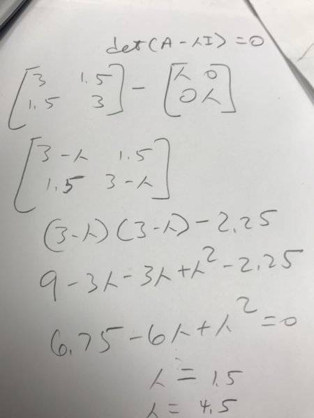

Yes, it is incorrect. I recalculated.
lambda = 1.5 and 4.5

Those still aren't right. The eigenvalues I get are both integer values. It would be helpful if you showed more of your work, such as the characteristic equation you're working with.
It's a good idea to check your work. If ##\lambda_1## is an eigenvalue with associated eigenvector ##\vec{x_1}##, then ##A\vec{x_1} = \lambda_1\vec{x_1}## should be a true statement. IOW, applying the matrix to an eigenvector should result in a scalar multiple of that eigenvector -- a vector that is longer or shorter or possibly pointing the opposite direction (if the eigenvalue is negative).

I checked my eigenvalues on MATLAB to be sure.
The hand calculation is also attached.

Yes, multiplied by 3/2.
OK, my mistake. I wasn't using that factor of 3/2 in my calculations. Since both of your eigenvalues are positive, the points on the circle in the directions of your eigenvectors will be stretched out by factors of 1.5 and 4.5.
