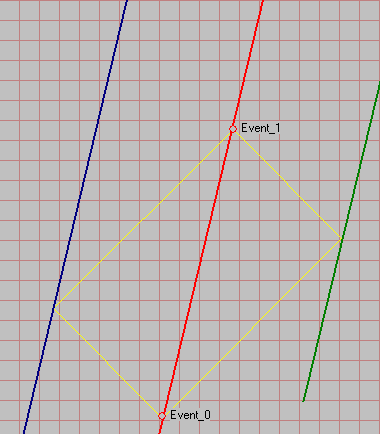

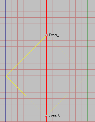

Your point comment after (2) is wrong.
2) Two lightning strikes occur just as M and M' are immediately adjacent.
(Technicality alert: M somehow knows the lighting strikes have already occurred, even before the light energy reaches him. Elsewise, the entire TE is even more muddled and problematic.)
M does not know this in advance and does not need to.
So is this
4) In the same time, the train, and M' have moved some dX towards B. But because of the peculiarities of relativity theory, M' experiences both flashes simultaneously as well... but at a position which is no longer immediately adjacent to M.
No. M' will not ever see the strikes be simultaneous if M has.
You are very confused and letting your disbelief override logic. Draw a space-time diagram and the relativity ( i.e. frame dependence) of simultaneity becoms clear.
For instance, see post#11 in this thread

M' will see the flashes at the same time. In order that the transmission events happen at the same time on M's clock, one flash is sent in each direction and reflected back. The returning light arrives simultaneosly at M's position - and all observers must agree on this. The diagrams illustrate this.

He'll see both flashes at the same time, of course. And, as Mentz114 illustrates, everyone must agree on this fact, regardless of frame. (Just like in the original thought experiment, where everyone agrees that both flashes reach M at the same time and M' at different times.)
