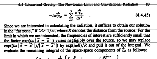

In section 4.4 of gravitational radiation chapter in Wald's general relativity, eq.4.4.49 shows the far-field generated by a variable mass quadrupole:
[itex] \gamma_{\mu \nu}(t,r)=\frac{2}{3R} \frac{d^2 q_{\mu \nu}}{dt^2} \bigg|_{t'=t-R/c} [/itex]
I have the following field from a rotating binary
[itex]
\gamma_{\mu \nu} = \frac{2 M}{3 R}
\begin{bmatrix}
2 & - r_o \omega(t \omega \cos{\omega t} + 2 \sin{\omega t} )& - r_0 ( \omega t \sin{\omega t} - 2 \cos{\omega t}) & 0 \\
- r_o \omega(t \omega \cos{\omega t} + 2 \sin{\omega t} ) & -2 r_o^2 \omega^2 \cos{2 \omega t} & - 2 r_o^2 \omega^2 \sin{2 \omega t} & 0 \\
- r_0 ( \omega t \sin{\omega t} - 2 \cos{\omega t}) & - 2 r_o^2 \omega^2 \sin{2 \omega t} & r_o^2 \omega^2 \cos{2 \omega t} & 0 \\
0 & 0 & 0 & 0
\end{bmatrix}
[/itex]
With [itex]r_o[/itex] being the orbital radius. I've computed (and double-checked) the Einstein tensor of this radiation field, taking
$$g_{\mu \nu} = \eta_{\mu \nu} + \gamma_{\mu \nu}(t',r) \Bigg|_{t'=t-R/c}$$

CharlesJQuarra said:
Here is the notebook content as a pdf
Ah, ok. On pg. 2 I see that you are assuming ##R = \sqrt{x^2 + y^2 + z^2}##. That is not a valid assumption in a curved spacetime.
Cartesian coordinates generally aren't a good choice for these cases anyway; spherical coordinates work much better. IIRC Wald is using spherical coordinates, which means you not only are incorrectly assuming that ##R = \sqrt{x^2 + y^2 + z^2}##, you are also incorrectly writing down the components of the tensors for the coordinates you are using. Wald's tensor components are not ##tt, tx, ty, tz##, and so on; they are ##tt, tr, t\theta, t\varphi##, and so on. So to even use Cartesian coordinates, you would first have to work out the correct coordinate transformation (which will not be the same as the ordinary transformation from spherical to Cartesian coordinates in Euclidean space), and then transform Wald's expressions using it. That is a lot of unnecessary work compared to just using spherical coordinates as Wald does.
One other comment: you can't assume that the coordinate speed of light is ##c## in a curved spacetime. So the correct retarded time at which to evaluate might not be ##t - R / c##.
I don't have any idea if the calculation is right or not. But if you've got a system that's radiating gravitational radiation, why would you expect the Einstein tensor to be zero?
it seems to me that any error on the assumption ##R = \sqrt{x^2 + y^2 + z^2}## should be smaller than the error in the paraxial approximation above
Error in what? Remember, ##x##, ##y##, and ##z## are not physical measurements; they're coordinates. ##R## is a physical measurement; it's the circumference of the object emitting the radiation, divided by ##2 \pi##. (This is assuming that Wald is using the Schwarzschild definition of the radial coordinate ##r##, which IIRC is what he uses in this example.) So the assumption ##R = \sqrt{x^2 + y^2 + z^2}## is not an assumption about how different physical measurements are related; it's an assumption about how your coordinate labels ##x##, ##y##, and ##z## relate to a physical measurement. (It also only applies to the ##x##, ##y##, and ##z## coordinates that are used to label the surface of the emitting object; it doesn't apply anywhere else, but ##x##, ##y##, and ##z##, as coordinates, need to cover all spatial locations, not just the surface of the object.) Any "error" in this assumption is an error in how you've written down all of your equations; it's not something you can assess by comparing measurements.
that is ##r_o## in the notebook, ##R## is the distance to the source, as it is explained in the snippet I quoted from Wald:
Ah, ok, that makes more sense, and it means that the retarded time ##t - R / c## is correct. But it still does not make it correct to assume ##R = \sqrt{x^2 + y^2 + z^2}##, because the geometry of space is not Euclidean.
Did you saw the quote of the approximation ##e^{I \omega | x' - x |}/| x' - x| \approx e^{I \omega R}/R##? This approximation assumes roughly that ##r_0 \ll R##, so we are already simplifying the dependence on the distance and ignore the size of the source. It would seem to me to be a much coarser simplification that assuming ##R \approx \sqrt{x^2 + y^2 + z^2}##
But let's suppose your hypothesis is correct, and the source of the non-zero Einstein tensor quantity is caused by an error in the coordinate dependence of ##R##. If that is true, if I replace ##R -> \sqrt{x^2 + y^2 + z^2} + \xi(t,x,y,z)##, where ##\xi(t,x,y,z)## is essentially the difference between the "real" ##R## and ##\sqrt{x^2+y^2+z^2}##, our approximating function, then the Einstein tensor non-zero components should have all to be functions of ##\xi(t,x,y,z)## and its derivatives. Otherwise, even with an exact ##R## expression, the Einstein tensor would evaluate to non-zero components
Do you agree?
You're missing my point. The approximation involving ##e^{I \omega}## etc. is a physical approximation. (Note that ##x## in this approximation is, I believe, a vector--the "position vector" of the location where the function is being evaluated. It's not the coordinate ##x## that you are trying to use.) The error in this approximation is, as you note, of order ##r_0 / R##; we can estimate that because both ##r_0## and ##R## are physical measurements, whose ratio is a physical quantity, an invariant, independent of our choice of coordinates.
The assumption that ##R \approx \sqrt{x^2 + y^2 + z^2}## is not a physical approximation; it's an error in your definition of the coordinates ##x##, ##y##, and ##z##. You can't even tell how wrong that makes your calculation unless you know the correct coordinate transformation from spherical coordinates to Cartesian coordinates for this particular curved spacetime. Do you?
In fact, I can state this in another way that doesn't even involve Cartesian coordinates. Suppose we're using spherical coordinates, and the point at which we're evaluating the metric tensor has radial coordinate ##r##. What value of ##r## corresponds to the physical distance ##R## from the center? The answer is not unique; there are different ways of constructing spherical coordinates that give different answers, and those ways correspond to different expressions for ##\gamma_{\mu \nu}## in terms of the coordinates.
I'm pretty sure, as I mentioned before, that the definition of spherical coordinates that Wald is using is the Schwarzschild one, in which the radial coordinate ##r## is the circumference of a circle at that radius (i.e., a circle composed of spatial points all lying in the same plane and all at the same distance from the center), divided by ##2 \pi##. With that convention, it is not true that ##R = r##, i.e., ##r## is not the physical distance from the center. The physical distance from the center is given by an integral:
R = \int_0^r \sqrt{g_{rr}} dr'
where ##g_{rr}## is the radial metric coefficient (possibly with a sign change to make the quantity under the square root positive, depending on what metric sign convention you are using). For the metric Wald is using, where ##g_{\mu \nu} = \eta_{\mu \nu} + \gamma_{\mu \nu}##, this integral would look like
R = \int_0^r \sqrt{1 + 2 r_o^2(t'(r'), r') \omega^2 \cos 2 \omega t'(r')} dr'
where I have put the functional dependencies into make clear that, at each value of the radial variable ##r'##, we have to evaluate the factors under the square root at that value of ##r'## and at the "retarded" value of ##t## corresponding to that ##r'##, which will be different for each ##r'##. Also, the value of ##t'## for a given ##r'## will not just be ##t' = t - r / c## (where ##t## with no prime symbol is the time at which we are evaluating the integral), because, again, ##r## is not the radial distance to the center. (Also, for small values of ##r##, we can no longer ignore ##r_o##, since it won't be much smaller than ##r'##.) What's more, we can't even assume that the difference between ##r## and the actual physical distance from the center is small.
