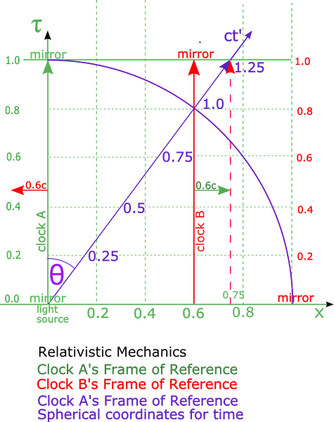

We can see this very simply with a moving light clock.
Clock A and clock B are synchronised and are together at t=0.
Clock B is traveling at 0.6 c from clock A.
After 1 second (proper time) the light pulses in clock A and Clock B will each hit the mirror in its clock. Measured objectively in each clock's reference frame and clock B will have traveled 0.6 light seconds from clock A.
However when we look at at the time taken for the light pulse in clock B to reach its mirror, measured in clock A's frame of reference, i.e. by a moving observer, the light pulse in clock B will have traveled 1.25 light seconds from clock A's light source to point (0.75,1.25).
In the native frame of the clock the light travels 1 second directly to the mirror and reflects back to the light source.
In the observers frame the clock is moving so after 1 second in the observers frame, the light must have traveled 1 light second from the source while the clock has also traveled 0.6 light seconds from the observer reaching point (0.6,0.8). This is the Lorentz transformation in effect, where the time of 1 second in the native(objective) frame is 'dilated' by the Lorentz factor γ (1.25 @ 0.6c) to 1.25 seconds; and the length of 0.75 light seconds is contracted by γ to 0.6 light seconds.
(The measurements of the moving frame B as seen by observer A are drawn in purple as spherical coordinates as this makes more sense that trying to make the round peg of time fit in the Cartesian square hole of Space)

The second one is like coordinate time. We need to establish some sort of association between us to answer it. First we need to determine if our feet are at the same level, then make sure that we're both standing upright, or how far off upright we both are.
Defining what we mean by "feet at the same level" (sea level? ground level? something else?) is like agreeing a simultaneity convention - what it is we are calling zero. Working out the angle between us is analogous to working out our relative velocity. But once we've done both of those things we have the basis of a coordinate system - we can use the same process to compare heights with anyone. But there's a degree of arbitrariness about it. Did we pick ground level or sea level as zero? Is one righter than the other? Not really, we just needed to agree a definition.
I hope that's a helpful picture. Proper time is a duration, like a length. Coordinate time the difference in the times shown by a pre-agreed set of clocks that are notionally synchronised.
Likes cianfa72 and Drakkith
