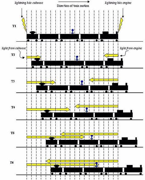

We all know the experiment - here
It says that for the observer on a train the lightning strike that we are traveling to happened first, but I have some questions.
1) We are moving towards right, so we must see the right lightning first. And we are moving away from left lightning so that light reaches us later than right lightning light. So that means that if the train speed is 0.5c, than we are moving towards right lightning at 1.5c and moving away from left lightning at 0.5c?
2) So for c to remain constant we say that for the reference frame on the moving train, the right lightning happened first?

First, There is nothing accelerated in the train thought experiment.
Second, you have to distinguish seing something at a certain time and the two things happening at the same time. In the train, these are equivalent because the lightnings are equidistant from the observer.
That is what I am asking - how do we know that the two lightnings didn't really strike at the same time but we are seeing it in different times because we are at different distances from it? Watching from the moving train reference point.
Since you know the speed of light and how far away the lightnings are, you can compute when they struck.
But to me the problem is in understanding this - it seems that for the observer on the train, that we are moving towards right lightning with 1.5c and moving away from left lightning with 0.5c.
No it does not. You cannot just add velocities in relativity. Light always moves with the speed of light. This is one of the relativity postulates.

No, I don't know how you could interpret my responses like that. The observer in the train will observe the flashes at different times because in his frame they occur at different times.
They occur at different times because the light needs time to reach the observer? Is that similar to this - the sun explodes and we see it on Earth. It has happened, but on Mars it is not happened yet since the light didn't react Mars yet?
No. They occur at different times because they occur at different times. It has nothing to do with the actual observation.

Because this follows directly from the postulates of special relativity. In relativity, there is no such thing as an absolute time defining events to be simultaneous, it all depends on the reference frame.
I think I understand now. An event has happened only when its light reaches us. As I said, any event on the Sun does not happen at the same time for Earth and for Mars, or any other planet?
No, this makes it obvious that you do not understand.
Whether two events are simultaneous or not in a given frame depends only on how the frame is moving, it has nothing to do with when light is observed.

The key point as explained by the figure is that the engine and caboose get hit by lightning, on that both the train's and embankment's frames must agree and that there is the same distance to the passenger from the engine and the caboose(in the passenger's frame) . The passenger on the the train observes the light coming from the engine before the light coming from the caboose, while the person at the embankment observes them simultaneously.Thus there is no absolute time. It can be left as an exercise for the reader to determine why an invariant speed c is compatible with traversing equal distances from the train's frame (engine and caboose to passenger) in different times.

The difference here is that the light bulbs are moving with the train. The lightning strike was stationary for external observer.
