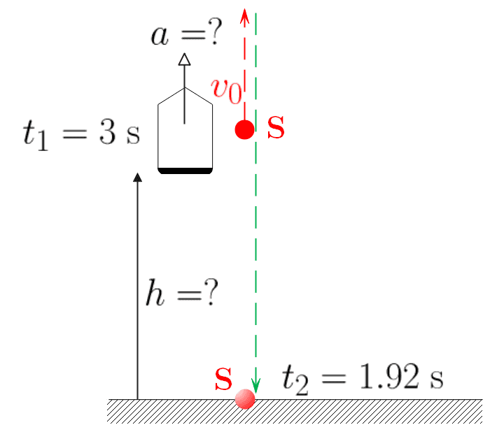

Bond and Scaramanga get into a helicopter which begins to accelerate upward at ##a\;\text{m/s}^2## for ##3\;\text{s}## at which point Scaramanga gets thrown out. He bites the dust ##4.92\;\text{s}## after liftoff. (i) What was ##a##? (ii) From what height did Scaramanga get ejected?

I start by drawing the diagram of the problem. Scaramanga (drawn as S) gets thrown out with a speed ##v_0## at time ##t_1=3\;\text{s}## from the helicopter which is accelerating at ##a\;\text{m/s}^2## starting from rest from the ground. After a time of ##t_2=1.92\;\text{s}## from then, S reaches the ground. Using equation ##(2)## above, we can write $$-h=v_0t_2-\frac{1}{2}gt_2^2\qquad\text{(4)}$$where using ##(1)##, ##v_0=at_1## and using ##(2)## again ##h=\frac{1}{2}at_1^2##.
Substituting in ##(4)##,
\begin{align*}
-\frac{1}{2}at_1^2 &= at_1t_2-\frac{1}{2}gt_2^2\\
\Rightarrow \frac{1}{2}gt_2^2 &= at_1t_2+\frac{1}{2}at_1^2\\
\Rightarrow a(t_1t_2+\frac{1}{2}t_1^2) &=\frac{1}{2}gt_2^2\\
\Rightarrow at_1(2t_2+t_1)&=gt_2^2\\
\Rightarrow a &= \dfrac{gt_2^2}{t_1(2t_2+t_1)}\\
\Rightarrow a &= \dfrac{10\times 1.92^2}{3(2\times 1.92+3)}\\
\Rightarrow &\boxed{a=2.54\;\text{m/s}^2}
\end{align*}
The height at which the throwing off took place : ##h = \frac{1}{2}at_1^2=\frac{1}{2}\times 2.54\times 3^2=\boxed{11.43\;\text{m}}##
Doubt : The problems don't match with those in the text that I copy and paste to the right.
Request : I'd like to know where have I gone wrong. Was it in the meaning of the term "liftoff"?

Your interpretation seems correct to me.
Likes PeroK, MatinSAR and TSny
@brotherbobby : The answers given in the text appear to come from assuming that S has zero velocity relative to the ground just after being thrown out of the helicopter. We don't have information about how S was thrown out. But, your assumption that S has zero velocity relative to the helicopter seems more reasonable. I agree with your answers.
Likes MatinSAR and erobz

The flaw in the supposed answer has been discussed here. After solving this problem, I agree with EulerJr's numerical answer of 1.76 m/s2 in the reddit.com link and disagree with @brotherbobby's answer of 2.54 m/s2.
Likes PeroK and TSny
Yes, am sorry, I made calculation errors. The acceleration of the spaceship is ##a = 1.76\;\rm{m/s^2}## and the height of ejection is ##\dfrac{1}{2}\times 1.76\times 3^2 = \rm{7.92\; m}##.
The crucial point of the exercise was the author's mistake. He assumed that an object thrown out of a moving vehicle is at rest relative to ground and not at rest relative to the vehicle.
