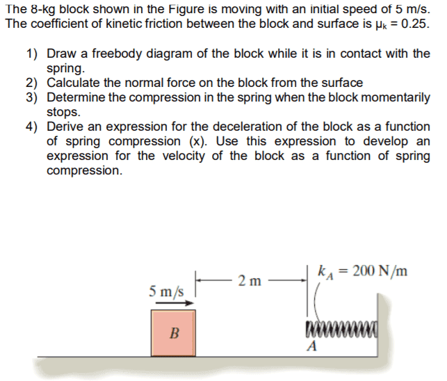

A 8kg block with an initial velocity of 5 m/s travels 2 meters before colliding with a spring.
Spring constant is 200n/m and the coefficient of friction between the block and surface is 0.25.
I've calculated that the block compresses the spring 0.7m before it momentarily stops. The next part asks to determine a expression for the deacceleration of the block in terms of the spring compression, then use that to determine a expression for the velocity in terms of spring compression.

The forces acting on the block in the horizonital direction are friction and the force of the spring. Choosing the direction towards the spring as the positive axis.
Therefore: F = ma
-Fr - kx = ma
Solving for a = (-Fr - kx)/m
If I plug in values I end up with a = (-(0.25*9.81*8)-(200*0.25))/8
a = -25x-2.2452
However, when I plug 0.7 into the equation it does not resolve to zero. I am unsure where I'm going wrong here?

You still have the constant kinetic friction term in your equation. Technically, your equation is only valid while the block is moving (in the positive ##x## direction).

Why should it? You calculated that x value based on the velocity becoming zero, not the acceleration.

You need to split the motion into two phases: first, sliding towards the spring; second, compressing the spring.
If you want velocity as a function of distance, then I would use energy.
Note that the diagram you posted shows the units associated with each quantity. You should do this too.
Thanks for the response @PeroK. I have already solved parts 1, 2 and 3 and used conservation of energy in two phases like you suggested for part 3. What's thrown me off the part 4. Are you saying I should apply ## F = ma ## in two phases for this question?
Using energy to find the velocity as a function of distance would be my go-to also. However as the question states derive the velocity from the acceleration expression, the only way I could think to do so was to use ## a ~ dx = v ~ dv ## and integrate both sides 🤷‍♂️

Part #4 says to derive acceleration as a function of position ##x## but to then use that to develop an expression for velocity as a function of position ##x##. I do not think it literally means you have to derive it from the acceleration formula you got but to just use it in another relation that relates the quantities you want.

It isn't necessary to split it like that to answer the first part. A single energy equation can be applied from the initial given state until the spring reaches maximum compression:
##(2+x)\mu mg+\frac 12kx^2=\frac 12mv^2##.
In post #1, @thatstheguy9 gave 0.7m for the maximum compression, and to one more decimal place I get 0.69m.
That said, solving the second part using ##a.dx=v.dv## requires the acceleration function to be smooth. So one way is to split it into those two phases; another is only solve it for the compression phase but use the maximum displacement and terminal velocity zero as the boundary condition, avoiding the need to find the velocity on reaching the spring.
@thatstheguy9 , can you solve ##a.dx=v.dv## for the compression phase?
