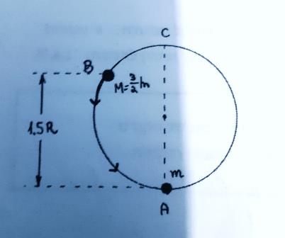

Please see the attached photo. (down)
Hminitial= 1.5R
M = 2/3m
Perfectly elastic collision
What is the velocity of object m immidiatly after the collision? (by m,g,R)
Conservation of energy
Conservation of momentum
I assumed that because of the elastic collision the M object bounce back, so I considered positive velocity to the right and negative to the left (when we're looking exactly on the collision moments)
First I found the "before the collision" velocity of the falling ball M (with conservation of energy) which is (3Rg)
Now I used two equation to find the velocities after the collision :
Conservation of momentum: MVi + 0 = MVf +mvf
Conservation of energy: V0 + Vf = v0 + vf
After some work I get :
Vf = ⅓⋅√(3Rg)
vf = 4⋅√(3Rg) / 3
It seems make sense when the speed of the small ball got higher and the big ball, which bounced backward, slower .
But in the other hand I know that the M velocity after the collision has to be negative. because it bounced back!, perfectly elastic collision...
But I got 2 positive answers!
when I try to change the direction/sign (to minus) of the variable MVf on the first equation I get different and not logical answer (Vf = √(3Rg) ) , like the bigger ball didn't lost energy at all while it was giving energy to the smaller ball...
Please some help :)
Thanks.
That's not true. They have to "bounce apart" (not stick together) and conserve kinetic energy, but the first mass needn't reverse direction. Imagine that first mass being 100 times more massive. Is it likely that hitting a small mass would make it move backwards?
You right. So basically the answers tell me that the bigger mass in this case didn't move backwards, It continued forward with third of its velocity?
Deadawake said:
You right. So basically the answers tell me that the bigger mass in this case didn't move backwards, It continue forward with third of its velocity?
Right!
Doc Al said:
Right!
Thank you very much.
For some reason I thought it needs to bounce backwards.
In a perfectly elastic head-on collision with a stationary object, the incomng object will bounce back if, and only if, it is lighter than the other. If they are equal it will come to rest.

Your result is not correct.
What am I missing?
Deadawake said:
What am I missing?
I do not know without seeing your work in detail.
The numerical values do not fulfill the equations for conservation of momentum and energy.
That equation for conservation of energy is incorrect.
Vf = ⅓⋅√(3Rg)
vf = 4⋅√(3Rg) / 3
Thus these results are incorrect.
Fix your conservation of energy equation and resolve.
Thanks to ehild for paying attention!
(Sorry for not checking your work earlier!)
It is correct, if Vi stands for V0 and vi stands for v0 in
V0 + Vf = v0 + vf
Capital letters refer to the big ball, small case letters mean the velocities of the small ball.
Likes Doc Al
V0 + Vf = v0 + vf
Once again, ehild is correct (as always). :bow:
(That equation isn't a statement of energy conservation only, but is a result of energy conservation plus momentum conservation.)
@Deadawake: You must have made an algebra/computational error; try it once more.
This is not true :redface:
Correct. this statement is result of conservation of energy and momentum equations.
Vbefore collision = √(3Rg)
1)
MV0 + 0 = MVf+mvf
⇒ 1.5mV0 = 1.5mVf +mvf
⇒ vf = 1.5⋅√(3Rg) - 1.5Vf
2)
V0 + Vf = v0 + vf
⇒ √(3Rg) +Vf = 0 +vf
⇒vf = √(3Rg) +Vf
⇒⇒⇒√(3Rg) +Vf = 1.5⋅√(3Rg) - 1.5Vf
⇒⇒⇒2.5Vf = 0.5⋅√(3Rg) →here was my error. I wrote 1.5 instead of 2.5
⇒⇒⇒Vf = 0.2√(3Rg)
⇒⇒⇒vf = √(3Rg) +0.2√(3Rg) = 1.2√(3Rg)
Deadawake said:
⇒⇒⇒Vf = 0.2√(3Rg)
Good. My answers agree with yours.
Some other question is - What height does the small mass ball reach after the collision? (hf)
(Just a reminder - we are talking about vertical standing circle/ring...)
So I have the initial speed of the small ball (after the collision) and I can use conservation of energy
½mv02 = mghf
½m⋅(1.2√3gh)2 = mghf
½⋅1.44⋅(3Rg) = g⋅hf
hf = 2.16⋅R
We know that the radius of the circle is R , so the maximum possible height is 2R.
Then the answer tells me that the small mass has enough energy to reach the top of the circle and a bit more.
The cunclusion is that the small ball will get to the maximum height which is 2R.
Am I right?
Sounds good to me.
