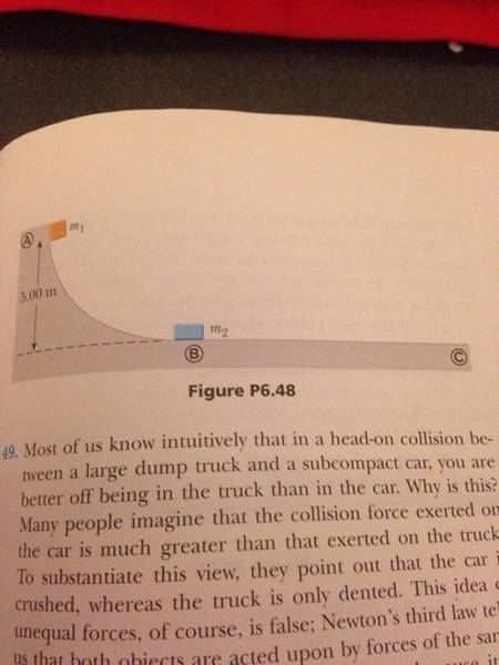

Consider a frictionless track as shown (I will attach an image in a follow up post). A block of mass M1= 5.00 kg is released from point A. It makes a head-on elastic collision at B with a block of mass m2 = 10 kg that is initially at rest. Calculate the maximum height to which m1 rises after the collision.

The top is the image that goes with the problem. Below is my work.

Looks like you found the collision velocity to be 10m/s, which is right if you are taking g as 10m/s2.
