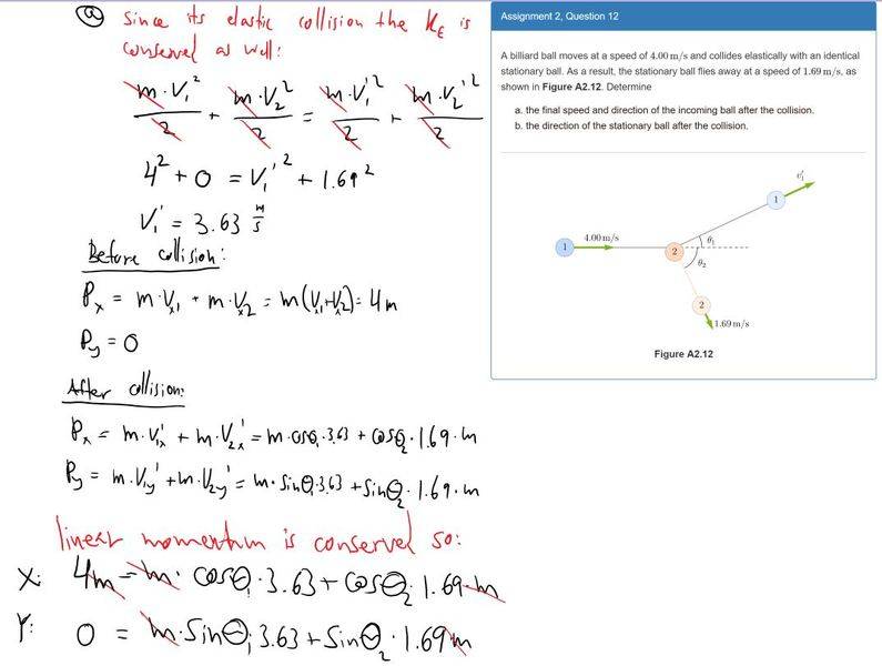

A billiard ball moves at a speed of 4.00m/s and collides elastically with an identical stationary ball. As a result, the stationary ball flies away at a speed of 1.69m/s, as shown in Figure A2.12. Determine:
  1. the final speed and direction of the incoming ball after the collision.
  2. the direction of the stationary ball after the collision.
Conservation of Energy and momentum:
E before = E after
Σpx=0
Σpy=0
As you can see, I have 2 equations with 2 angles that I don't know.
However, I couldn't find the right way to solve it due to trigonometry complexity.
I am sure that taking into account the fact that (sin(theta))^2 +(cos(theta))^2 = 1 would help in some way.
https://image.ibb.co/gv6YVw/Capture.jpg
Hi again,
As long as I can see, you use the right method. You are right, the equation sin2θ1+cos2θ1=1 can help you.
You must think how you can form this (sin2θ1+cos2θ1). Try to "play" with these two equations. (Hint: You will end up solving an equation with only one of the two angles firstly).
Yes, it would, Arrange the momentum equations in the form sin(θ2)=... cos(θ2)=...
Square them and add.
If you take the two resultant momentum vectors after the collision and add them (i.e. put them tip to tail with each other), then, by conservation of momentum, you have the initial momentum vector.
This gives you a triangle where you know the lengths of all three sides. You could, therefore, use the cosine rule to get a simpler equation for each angle separately.
You could try this technique, as I find it a simpler method for collision problems.
