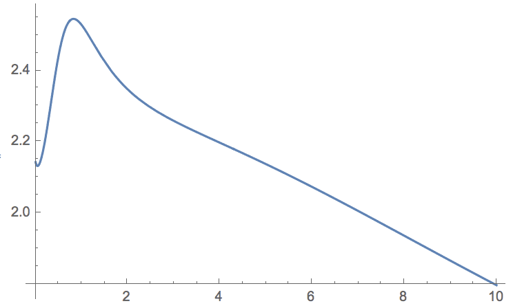

The general form of the solution should relate x, L, m, g, and k. Those are five variables with three basic physical dimensions. You can therefore construct two dimensionless combinations:
\pi_1 = \frac{kx}{mg}, \quad \pi_2 = \frac{kL}{mg}.
By Buckingham’s pi theorem, this implies that
\pi_1 = f(\pi_2) \quad \Longrightarrow \quad
x = \frac{mg}{k} f(kL/mg),
where ##f## is some dimensionless function. This is the closest you can get without looking at the equations of motion.
Likes BvU
Assuming that I entered everything into Mathematica correctly, this is what I get numerically for ##f(\pi_2)## in the range 0 to 10, clearly a non-trivial behaviour:

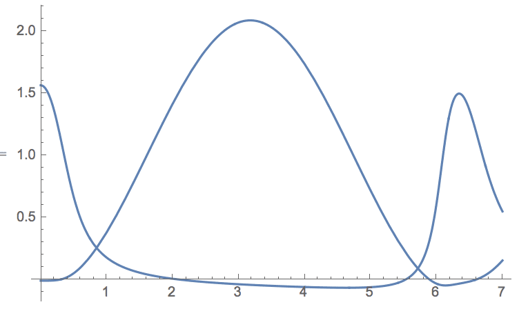

I think we already concluded that the problem constructor has made a logical blooper somewhere along the way. For definiteness, these are the solutions I get for ##\pi_2 = 0.01##, i.e., essentially in the small ##L## limit (##\theta## being the coordinate starting at ##\pi/2##):
Clearly ##\dot x \neq 0## when ##\theta = 0##, indicating that the motion indeed is not horizontal at ##\theta = 0##. Instead, the elongation in ##x## has already passed its largest value and the mass is again on its way up.

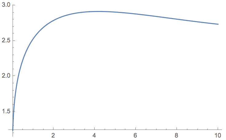

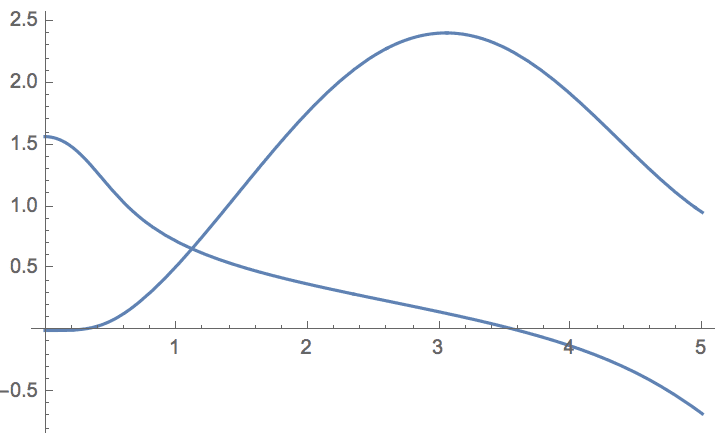

It turns out I indeed had a typo stemming from when I started using units of ##m##, ##k##, and ##g## instead of ##m##, ##L##, and ##g## ... These are the corrected plots:
Small L regime (L = 0.01)
Maximal x around 2mg/k. This makes sense, it is essentially dropping the mass attached to a spring and solving mgx = kx^2/2.
##f(\pi_2)##

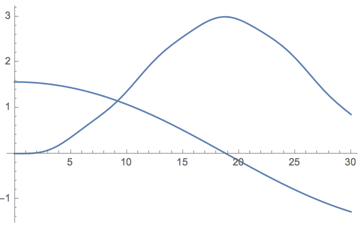

Large L regime (L = 100)
There are some wiggles on the ##x## solution due to the oscillations around the force equilibrium, but their amplitude is small relative to the amplitude of the force equilibrium itself. Indeed, the maximal extension is ##x \simeq 3mg/k## at ##\theta \simeq 0##.

Obviously, this was a quick mashup and I think it is fairly self-explanatory based on the written descriptions. Anyway, the solutions are the generalised coordinates (in units of ##mg/k## and ##1##, respectively) as a function of time in units of ##\sqrt{m/k}##. The plot of ##f(\pi_2)## is just a plot of a dimensionless function of a dimensionless variable.
