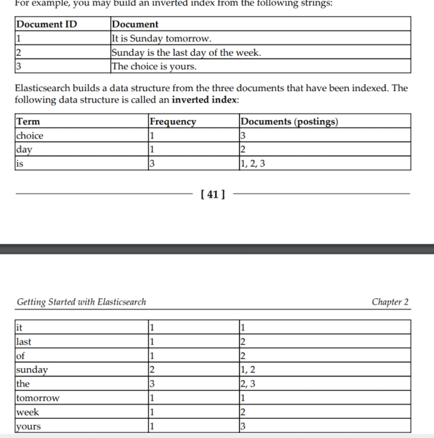

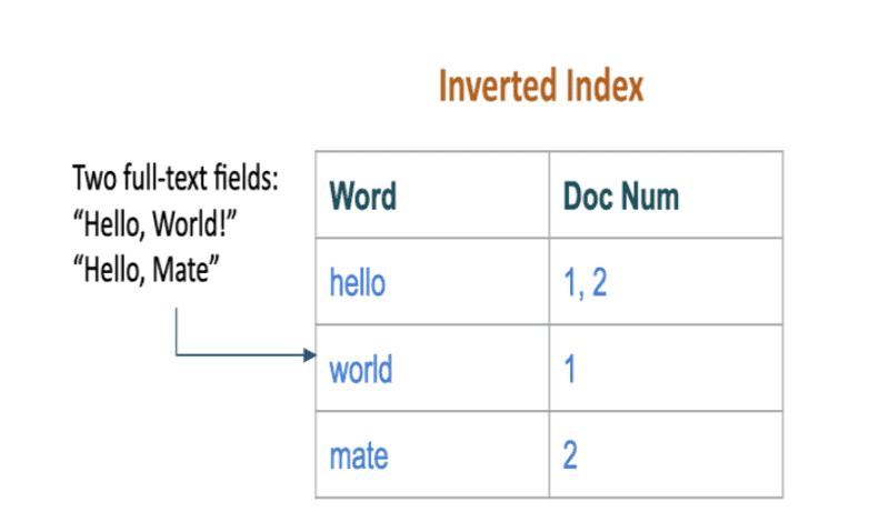

shivajikobardan said:
term-document arrangement is called inverted index though. what's the term here? ig the value is it ie 2022-02-02 or?
You wrote this: date_of_join=>doc1,2022/2/2.
Even if you are confused as to what a 'term' is, I think it's pretty clear which is a document, and if we are looking for a term-document index then the document must come second.
I am not sure what is going wrong here, these concepts should not be difficult to grasp. Perhaps you should take a break.
(They use BKD trees for numeric data type though)
There is no numeric type involved here, just date and string. And the implementation details are entirely irrelevant to using Elasticsearch - they could change to a KDB tree and it wouldn't change anything.
Document is differently defined in different contexts.
1) Document of elasticsearch
2) document what normal people know
term-document means the figure like the one I posted above.
Like this-:
So anything with "document id" on the right side would be inverted because the classic data mining etc technique was to use document-term which would be sparse here.
Since document id is in right side, it should be an inverted index Isn't it?
But according to above analogy, I'd think
2022/2/2->doc1
should be inverted index more accurately.
We are talking about doc1 -> 2022/2/2 where the document id is clearly on the left side.
I'd think 2022/2/2->doc should be inverted index more accurately.
Yes, that was my point, which is the exact opposite of what you have been saying.
