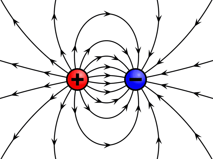

In summary: Well, basically, the electric field pushes the arc in the direction of the field. That is why arcs tend to curve upward. If the electric field is strong enough, the arc will stay in that direction and won't curve. If the electric field is weak, the arc will curve.

I observe that electric arc forms a curve. I think that this is because electric arc is extremely hot and hot air goes up because it has less density. So if electric arc occur at 0 gravity would it be straight?

No, it isn't.
When the arc passes through an airgap, it needs free charged particles ( ions/electrons ) to be created along the path. Having one particle created, the particle will be accelerated along the electric field, achieving velocity/energy. And if the achieved energy matches the energy needed to create a new free charged particle, at that instance the first particle hits a molecule, this will happen. So in turn, an avalanche/electric arc will be created.
So creation of an arc depends on:
  1. Electric field strength ( not too high, not too low )
  2. Density of gas ( distance between molecules, gas pressure )
  3. Sort of gas ( oxygen, hydrogen )
Now, say the electric field strength is too high, the arc must choose a path where along the field strength is weakened. At the same time it must follow the direction of the electric field. So if the difference in voltage is kept constant between "+" and "-" in the below figure, the arc must follow a longer/curved path. In this way, the field strength will be weakened. So if the applied voltage is close to the minimum voltage needed, the arc will be straight. With more voltage applied, the arc will be curved.
