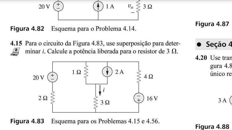

Exercise 4.15 on the image.
The exercise asks for the value of the current I using superposition
Superposition theorem, nodal and mesh analysis
I think i am doing the mesh analysis wrong, but can't see where. Can someone give me feedback?
