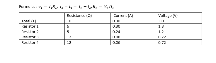

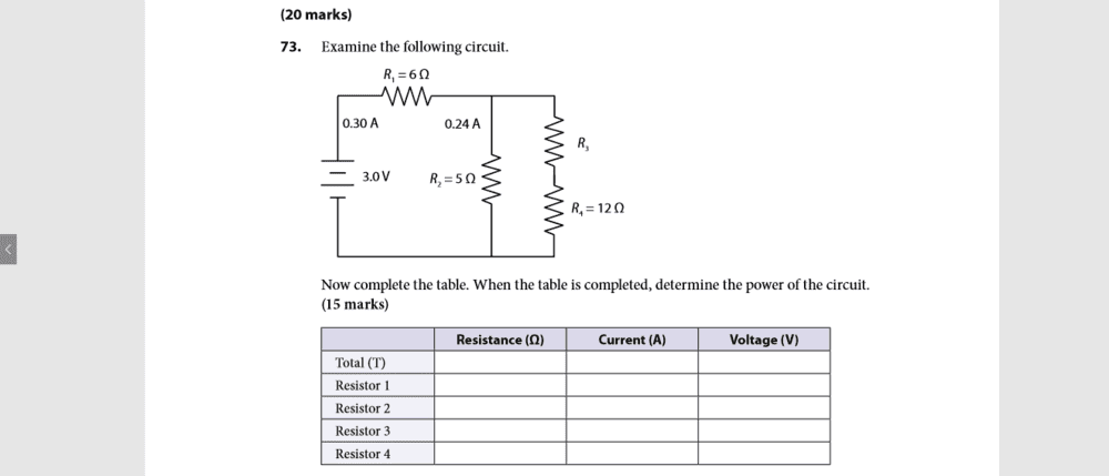

Examine circuit and complete table and determine the power of the circuit.
v_1= I_1 R_1,I_3=I_4= I_T-I_2,R_T= V_T/I_T
246044
I made a chart and this is my attempt. I am not sure that I am doing the calculations right thou
246045
(1) Since there is no value for r3, the problem is unsolvable except as equations using r3 as the independent variable
(2) Show your work (I'm assuming YOU have a value for r3)
No there is no value for R3
Then your answers are all bogus.
I was assuming because R3 and R4 are parallel that the values would be the same.
r3 and r4 are NOT in parallel, they are in series and there is zero reason to assume they have the same value whether they are series or parallel.

You know the voltage across R2. It is parallel with the chain R3 , R4, so the voltage is the same across the chain. You know the current through that chain. From the current, determine the voltage across R4. so you can get the voltage across R3.
I am lost on how to find this. I was multiplying the resistance by the current? I am assuming that is not the formula
Why not?
Do you know Ohm's Law? The current through R4 is 0.06 A, The resistance R4 is 12 ohm. So what is the voltage across R4?
