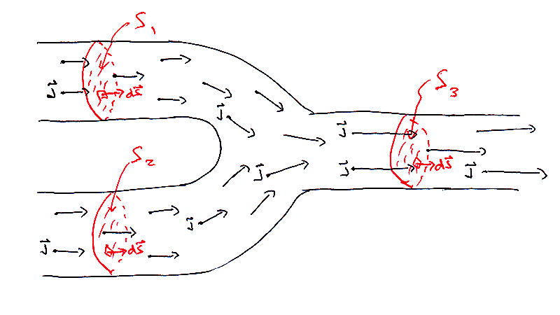

The way I picture this is that there is a single ##\vec j## field that is distributed through the interior of the wires and their junction region. We get the different currents in each wire by integrating over different surfaces that span each wire separately.
$$\int_{S_1} {\vec j \cdot d \vec S} + \int_{S_2} {\vec j \cdot d \vec S} = \int_{S_3} {\vec j \cdot d \vec S} \\ I_1 + I_2 = I_3$$
Likes vanhees71, etotheipi and Delta2
