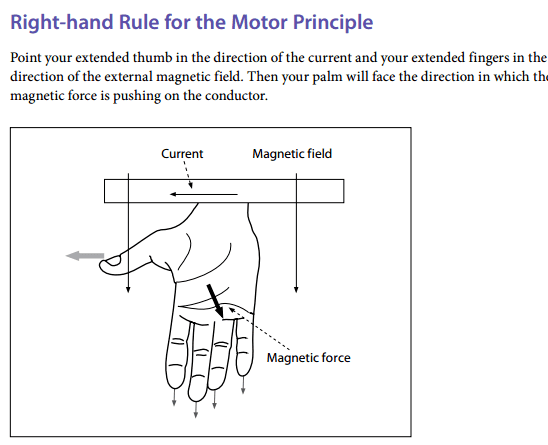

so here are my answers, i just want to know if they are correct.
also, I am really confused about the function of the commutator in the DC motor, the answer i wrote for part b) was based on research off random websites that didnt really make sense, i don't actually understand how a commutator functions and its purpose, can someone please explain in simple terms.
thanks for the help!
78.
a) the answer is Clockwise,
i used the right-hand rule for the motor principle to figure out the direction of the magnetic force acting on the conductor. As shown below:
It's actually the left-hand rule. Right hand rule is for the generator principle.

the lesson I am doing called it the right hand rule??
I don't know where they got it from:wink:. But it's definitely the left hand rule. Right hand rule is for generator action. It follows from Lenz's law.
