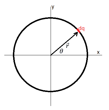

Text description: Let V(z) be the potential of a ring of charge on the axis of symmetry at
distance z from the center. Obtain the first two non-vanishing terms of the multipole expansion
for V(z) with z>>a where a is the radius of the ring. Can you see by symmetry that the dipole moment is
zero?
My issue: While I was able to do the monopole term just fine. The problem is with the dipole
moment term. My work (outlined below) keeps giving me a positive term, however intuition
and the geometry of the problem (as well at the text's statement of the problem)
dictate that the dipole moment is zero. Can anyone point out where I went wrong in my work?2. Homework Equations
a)Definition of the Electric Dipole Moment for a continuous body
##\vec p(\vec{x'})=\int \vec{x'} \lambda {dx'}##
b)My Setup
##\vec p(\vec{x'})=\lambda a^2 \int_{0}^{2\pi}\hat{s}{d\phi'}##[/B]
The following is the result I have gotten to thus far.
[/B]
##\vec p(\vec{x'})={2\pi}\lambda a^2\hat{s}##
##\hat{s}## is not a constant vector in the integration.
See, I am aware of that, but I am not quite sure how to decompose it such that all of the source point vectors cancel out when you integrate. Do I have to switch over to Cartesian neccesarily?
I would switch to Cartesian coordinates and show that each Cartesian component of the dipole moment vector p is zero.
I tried that, but so far I've been stumped in that way. However, another way came to mind. It gives the right answer and would like your opinion. If you orient the ring such that the diameter is collinear with the z-axis, the differential length along the curve will equal to ##a{d\theta}##. If you integrate over the whole ring, you will first have to integrate from 0 to ##\pi## then you would integrate from ##\pi## to 0. The result does end up giving zero (as stated before) and seems plausible enough, but I would be grateful for any second opinions from anyone. :)
Implicit in my above post is the fact that I have switched to Spherical Coordinates to work the problem.
It might be confusing to use ##\vec{x}'## as the position vector of an element of charge. Maybe use ##\vec{r}## instead. Then ##\vec{p} = \int{\vec{r} dq}##. The x-component would be ##p_x = \int{x dq}##. Write ##xdq## in terms of ##a##, ##\theta## and ##d\theta##. See what you get.

I didn't really follow your reasoning in post #5. It would help me if you could please show more details of what you did.
The way I suggested to do it is just a way that seems natural to me. The integrals for ##p_x## and ##p_y## are very simple to evaluate. ##p_z## is trivial. (I'm taking the ring to lie in the xy plane with the z-axis running along the axis of the ring.)

I don't think this is a valid way to get zero for the answer. Note that in your second integral you are letting ##\theta## go from ##\pi## to 0. So ##\theta## is decreasing. That means ##d\theta## is a negative quantity and so you would be treating the charge elements as negatively charged according to your expression ##dC'##=##ad\theta##.
If you want to try the Cartesian component approach (with the ring in the xy plane), then we had ##p_x = \int{x} dq##. If you let ##\theta## be the angle of the location of ##dq## as measured from the x axis, then ##dq = \lambda a d\theta## and ##x = a \cos \theta##.
