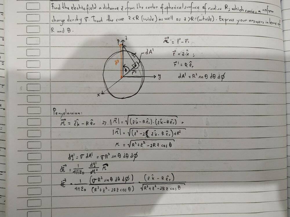

Electric field a distance z from the center of a spherical surface
In summary, the conversation is about solving a problem involving Coulomb's Law and spherical coordinates. The hint given was to use geometry to find ##r^2## instead of vectors. The integral can be easily solved in spherical coordinates, but it is recommended to solve the potential problem instead. The solution to the potential problem is simpler using directly the differential equation. The charge distribution is spherically symmetric, so the electric field outside the sphere will be identical to that of a point charge at the origin. There is a mistake in the calculation of the electric field, which is caused by assuming that ##\hat r## is the same for both ##\vec{r}## and ##\vec{r'}##. The correct expression for
agnimusayoti
240
23
Find the electric field a distance z from the center of a spherical surface of radius R which carries a uniform charge density ##\sigma##. Hint: use the law of cosines to write r in terms of R and ##\theta## where ##\theta## is inclination/elevation angle of sphere.
Coulomb's Law: $$dE=\frac{1}{4 \pi \epsilon_0} \frac{dq}{r^2}$$
Well, I really don't understand what is the use of the hint.
I try to solve this problem with Coulomb's Law and try to do in spherical coordinates and got very messy infinitesimal field due to the charge of infinitesimal surface element of the sphere.
Here what I got:
$$\vec{r}=\vec{r_P} + \vec{R}$$ where ##\vec{r}## is position of the point of field (P in question) relative to infinitesimal surface element; ##\vec{r_P}## is position of the point of field relative to the origin, and ##\vec{R}## is position of vector radius of the sphere; as shown in figure.
I get, $$\vec{r} = (z cos \theta - R)\hat{r} - z sin\theta \hat{\theta}$$.
With the domain of integration ##0<=\theta<=\pi## ##0<=\\phi<=2\pi##; how I can solve the integration and find the electric field?
Second, is there another method which is easier? Thankss
This is Prob 2.7 at Griffith Introduction to Electrodynamics

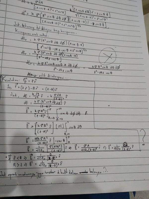

1) The hint was to use Geometry of problem to find ##r^2## rather then vectors. Since, you used Vectors, that is just fine.
2) The integral is easy to do in in this case.
Yes I Made a mistake. The ##\vec{r_P} = z \hat {r} ## so that the integral can be done easily in spherical coordinate. I get $$E = \frac{1}{4\pi \epsilon_0} \frac {Q}{(z-R)^2}$$. Is that true?

I expect zero electric field inside the Shell, which I don't get on my answer
agnimusayoti said:
Check your solution again.
It is better to write the position vectors and unit vectors using Cartesian unit vectors since they are fixed during integration whereas spherical units vary.
No. It's a spherically symmetric charge distribution, so the field outside of the sphere will be identical to that of a point charge at the origin.

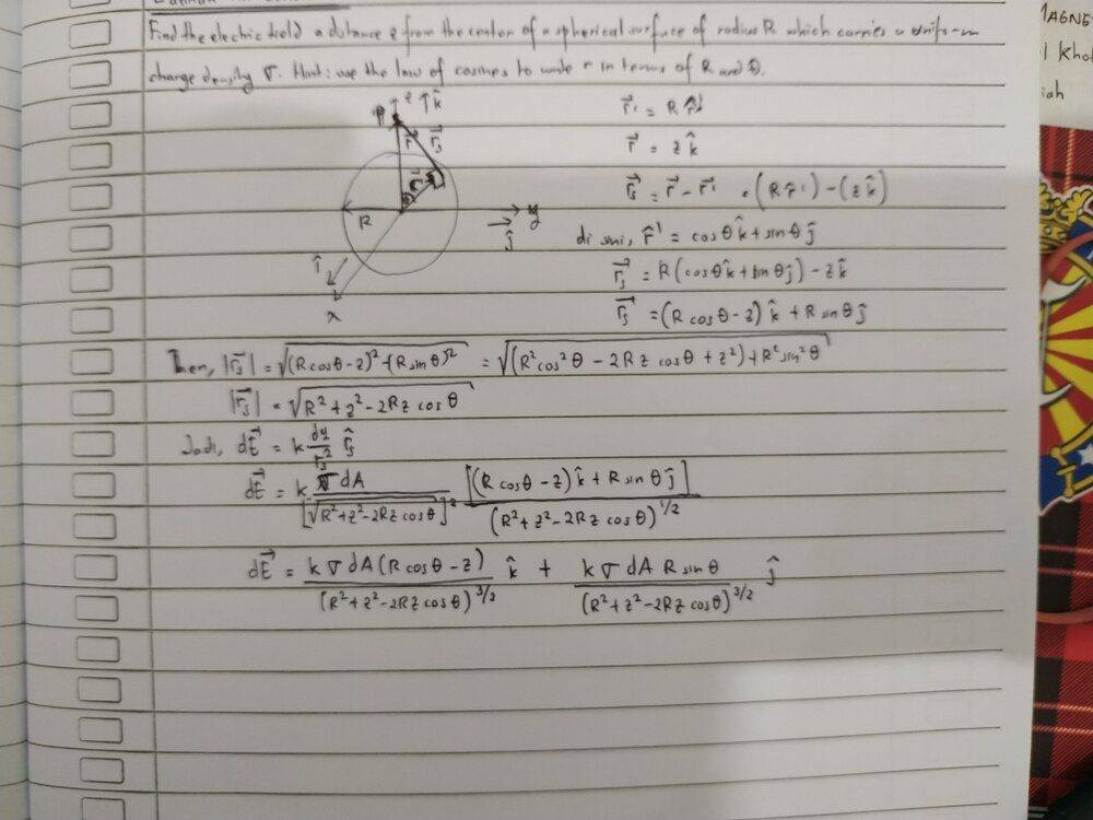

I'm going to stick with Griffiths' notation because I find yours hard to keep straight. The location of point ##P## is ##\vec r = z\,\hat k##, and the location of the infinitesimal area on the sphere is ##\vec r' = R\,\hat r'##. Their difference is what Griffiths denotes by script r, which I'll write as ##\vec r_s = \vec r - \vec r'##.
One mistake you made was assuming ##\hat r## is the same for ##\vec r## and ##\vec r'##. It's not.
The hint given is to use the law of cosines to find ##r_s = \| \vec r_s \|##, but you can find the same result using the vectors:
$$\| \vec r_s \|^2 = (\vec r - \vec r')^2 = \vec r^2 + \vec r'^2 - 2 \vec r \cdot \vec r' = z^2 + R^2 - 2 z R \cos\theta$$ where ##\theta## is the angle between the ##z##-axis and ##\vec r'##. Note that this is different than the expression you obtained. Because you effectively assumed ##\vec r## and ##\vec r'## point in the same direction (same ##\hat r##), you had ##\theta = 0##, so you ended up with ##r_s = z^2 + R^2 - 2zR = (z-R)^2##.
Likes vanhees71, agnimusayoti and Abhishek11235
Nah. At the first, I think ##\vec {r}## is different with ##\vec{r'}## but in spherical coordinate the integral was not good, because I need to change ##\hat{k}## into unit vector in spherical coordinate.
Then, If I want to use Cartesian, then I must define ##\hat{r'}## into unit vector Cartesian,
which is the same for unit vector radial in spherical coordinate. Is this true?
So, $$\hat{r'}=\sin \theta \cos\phi \hat{i} +\sin \theta \sin\phi \hat{j} + \cos \theta \hat{k}$$
Or, $$\hat{r'}=\sin \theta \hat{j} + \cos \theta \hat {k}$$?
I think the second is the true one, becouse it give the same result as you have shown.
But, how can the problem become two dimensional problem? At first, I think ##\hat {r'}## is a 3D vector..
agnimusayoti said:
Nah. At the first, I think r→ is different with r′→ but in spherical coordinate the integral was not good, because I need to change k^ into unit vector in spherical coordinate.
You wrote ##\vec r = z\,\hat r## (your ##\vec r_P##) and ##\vec r' = R\,\hat r## (your ##\vec R##). Then you said ##\vec r_s = z\,\hat r - R \,\hat r = (z-R)\,\hat r##. By treating the ##\hat r## in ##\vec r## and the ##\hat r## in ##\vec r'## as equal (because that's what you did when you factored it out), you're making ##\vec r## and ##\vec r'## point in the same direction. That may not be what you meant to do, but that's what you did.
Likes agnimusayoti
Yup, I wrote and assume the unit vector is radially outward because I hope the integration is easy to do.
At this stage, am I correct?
I'm not sure you're understanding my point.
No. It's wrong for the reason you suspected. This isn't a two-dimensional problem. You can, however, use symmetry to simplify the problem.

Well, let's write down the correct "relevant equation",
$$\vec{E}(\vec{r})=\frac{\sigma}{4 \pi \epsilon_0} \int_{S_R} \mathrm{d}^2 f' \frac{\vec{r}-\vec{r}'}{|\vec{r}-\vec{r}'|^3}.$$
Now parametrize the spherical shell with radius ##R## with spherical coordinates. Think about first how to express ##\mathrm{d}^2 f'## in terms of the spherical coordinates.
Further you can assume from symmetry that ##\vec{E}=E_r \vec{e}_r## and then choose ##\vec{r}=r \vec{e}_z##, which implifies the integral considerably.

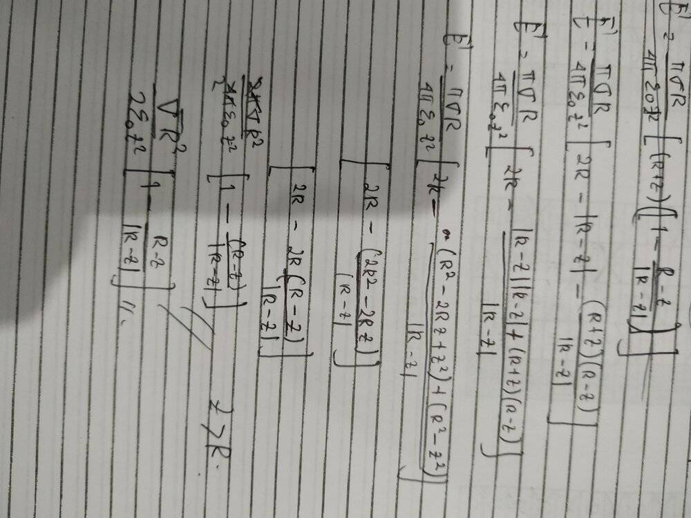

Is ##d^2f## same with ##dA## surface infinitesimal element? Then, ##d^2f=R^2 \sin \theta d\theta d\phi## in spherical coordinates. Is this right?
I look Youtube video about this problem, but I don't understand how one can use spherical coordinate, but at the same moment, he got the electric field is at the z direction, which is Cartesian.
If I choose ##\vec{r}=r \vec{e}_z##; then what kind of coordinate that I am going to use?
right!
Likes Delta2
Just calculate ##\vec{r}-\vec{r}'## and ##|\vec{r}-\vec{r}'|## to get the integral and then solve it!
Likes Delta2
Is this ok?
Looks good. Now express ##\hat{e}_r## in terms of ##\theta## and ##\varphi## and Cartesian basis vectors. Then you can go on and evaluate the surface integral.
Likes agnimusayoti
Yesss. I got the result. So, it's ok to use spherical domain of integration in cartesian coord right.. then, by spherical simetry, the field is only z direction. Thanks!
