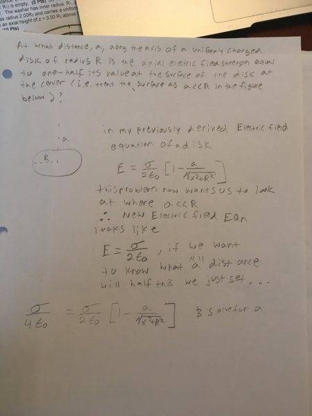

At what distance, a, along the axis of a uniformly charged disk of radius R is the axial electric field strength equal to one half its value at the surface of the disk at the center.
electric field of disk (attached)

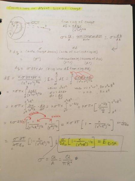

First I derived the electric field of a disk
E=σ/2ε0 [1-(a/(x^2 +R^2)^(1/2))] (attached).
This problem wants us to look at where a<<R, Therefore the new electric field equation in that limiting case is:
E=σ/2ε0
If we want to know what "a" distance will half this electric field we:
(σ/4piε0) = σ/2ε0 [1-(a/(x^2 +R^2)^(1/2))] and solve for a?

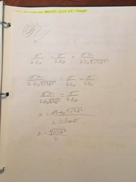

I have attached my work, Attachments are labeled accordingly.
My final result for a-
a= (x^2 + R^2)^(1/2) / 2

Your original formula should read ## E_z=(\frac{\sigma}{2 \epsilon_o})(1-\frac{z}{\sqrt{z^2+R^2}} ) ##. Otherwise you approach is correct, but you need to have ## z=a ## in both places. (Usually ## z ## is used for the on-axis direction).

In this problem, there is a long way to solve for ## a ##, but also a shortcut. If you look at the equation, it is basically ## \frac{\sigma}{4 \epsilon_o}=\frac{\sigma}{2 \epsilon_o}(1- cos(\theta)) ##. Clearly ## cos(\theta)=1/2 ## and that angle is one you should know. (In post 1 I see you have an incorrect ## pi ## in the denominator on the left side).

Those attached pages a nearly impossible for me to read.
I know Charles was able to decipher these and the ones with your previous thread, but such difficult to read images are discouraged on these Forums.
Where did that pi come from in the denominator on the left ?

Again: What is ' x ' doing there ?

Yes I used "x" instead of "a" (definitely confusing) sorry. I was working from a previously derived equation that used different variables, should have switched back.
To answer your question the x was meant to be the distance from the center of the disk (on axis).
After looking back at my work I believe the pi is incorrect (so used to writing 1/(4piε0)

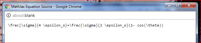

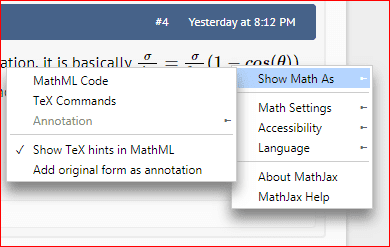

Could you explain how you do that LaTex thing with the division?
@cookiemnstr510510 Although you might find "Latex" kind of slow when you are first using it, I also recommend you try to use it, if possible. For a while, you might find yourself needing to do a "google" to figure out how do do something in Latex, but with a little practice, you are likely to get pretty good with using it. ## \\ ## I myself had only used Latex for typing up one paper before joining the Physics Forums two and a half years ago, but I also got better at it with a little practice. It is somewhat slower than doing things by hand, but it's manageable.
Likes cookiemnstr510510
SammyS said:
I could have said more than that, but I was busy trying to juggle answering a couple of other threads at the time.
Some helpful points in using Latex .
Find a an expression that somebody has typeset in Latex. Right click on that expression. A window pops up as below. Click on "Show Math As" then choose Tex Commands.
I did this for the first equation found in Post #4 of this thread, written by Charles and the following browser window popped up.
See the Latex code which produced: ##\ \frac{\sigma}{4 \epsilon_o}=\frac{\sigma}{2 \epsilon_o}(1- cos(\theta)) \ ## in that post.
Notice that if you use the "Reply" feature in answering a thread, the Latex code will show in the message input box along with the rest of the Post, and the Latex code will include the # signs or $ signs mentioned in the following.
What is not displayed in that is that the code must either place a pair of pound signs, ## , before and a pair after the Latex to get an 'inline' expression, like in Post #4, else use a pair of dollar signs, $$ , before and after. This will display your expression centered on its own line. There are other differences in the way these two options display the expressions, most notably the height of expressions, including fractions.
