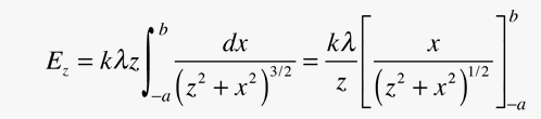

The electric field, E, at the point, P, will be equal to the electric field at the line segment of x + the electric field at the line segment of y?
dEz = (kλdx / r2) (z/r)
Ez= kλz ∫ dx / (z2 + x2)3/2
Ez= kλ / z [x / (z2 + x2)1/2]
Ez= kλ / z [b / (z2 + b2)1/2 + a / (z2 + a2)1/2]
for the x line: a=-0.05, b=0.05
for the y line: a=-0.10, b=+0.10
z=0.10
λ =4 μC/m2
k = 8.98 * 109 N m2 C-2
Do you know the expression for the electric field for a line of charge of length L a height z above the center?

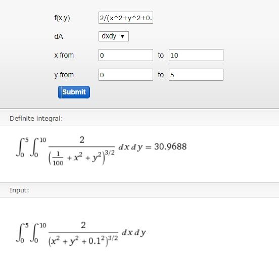

Are there any simplifications / substitutions I can make here? The integral looks a little tricky without a calculator or tables.
I put the function in Wolfram and just substituted r=0.10m into the equation. If I multiply this calculation by σr / 4πε0 then I will get the electric field at the point, P.
says said:
2 ∫ 1 / (x2 + y2 + r2)3/2 dx [x: from 0 to 10cm]
This is why you were told to use the standard formula for the first integration stage.
Look at the formula in the first line at http://hyperphysics.phy-astr.gsu.edu/hbase/electric/elelin.html:
What can you substitute for the k, λ, z, a and b in there to make it match your integral?
k = 8.98 * 109
λ = 4*10^-6
a = 0
b=0.10m
z=0.10m
Ez = 2kλz ∫ dx / (z2 + x2)3/2
Ez = 2kλ/z [ x / (z2 + x2)1/2 (evaluated from 0 to 10)
Ez = 2*8.98*109*4*10-6 / 0.10 [ 0.10 / (0.102 + 0.102)1/2]
Ez = 718400 / 0.70711
Ez = 1015966

No, that does not make the left hand side of the equation look like your integral.
Study my post #27. What has to replace z to make the integrand look like the one in the integral I quoted from your post?
The z in the hyperphysics diagram is the distance from the charge to the point P. I'm guessing the z in post #27 should be y for when we integrate dy
No need to guess. Just study the two integrals in post #27. What do you have to replace the z2 inside the second integral (the one from the link) with in order to make it look like the integrand that I quoted just above it?
the z2 inside the second integral would be y2
No, that would make the integrand ##(x^2+y^2)^{-\frac 32}##. You need ##(x^2+y^2+r^2)^{-\frac 32}##

k = 8.98 * 109
λ = 4*10^-6
a = 0
b=0.10m
z = y2 + r2
Ez = 2kλ/y2 + r2 [ x / (y2 + r2 + x2)1/2] (evaluated from 0 to 10)

says said:
z = y2+ r2
Closer.
