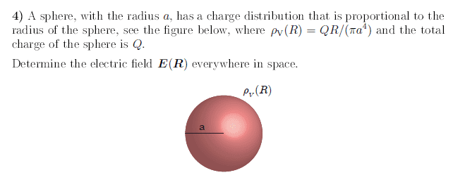

see picture
integral E ds = integral charge distribution * 4*pi*R^2 dR
I'm just going to skip some of the step since I only need help with understanding the last part.
After rearranging the equation stated at "Relevant equation" (and skipping some steps) we will get:
E * 4*pi*e0*R^2 = integral pv * 4*pi*R^2 dR
E = 1/(4*pi*e0*R^2) * 4*pi * integral pv*R^2 dR
E = 1/(e0*R^2) * Q/(pi*a^4) * integral R^3 dR
E = Q / (pi*a^4*e0*R^2) * integral R^3 dR
Now for the last step is where I'm unsure where to put the integral limits.
Inside the sphere (0<R<a): the integral should be from 0 to a?
Outside the sphere (R>a): the integral should be from a to R?

goohu said:
Homework Statement:: see picture
Relevant Equations:: integral E ds = integral charge distribution * 4*pi*R^2 dR
We most certainly will not. Your left-hand side depends on R while it is an integration variable on the right.

Sorry for the late reply.
Gauss law states that the net electric flux of a closed surface is equal to the total electric charge inside the surface divided by e0.
The electric flux is the electric field vectors going through the surface at the normal angle.
E * 4*pi*r^2 = (1/e0) * ∫ pv dV , where pv is the charge distribution and dV is a volume unit.
We can rewrite dV into dr dtheta dphi-> looking at my formula sheet this becomes 4*pi*r^2 dr. This is the same answer to what I got before.
I don't understand what is wrong, there was a similar task solved in class by the teacher. That task was : "Determine the electric field everywhere from the charge distribution given by: " pv = {4R, 0<=R<1 ; 5^2 , 1<= R < 2 ; -8, R = 2}
I'm really confused.
OK, so you're using a spherical Gaussian surface of radius ##r##. What limits do you use to find the charge inside the Gaussian surface for the case where ##r<a##?
If its inside the sphere then I think the limits should be from 0 to r.
And what happens outside the sphere? I suppose outside the sphere is just empty space so no contribution to the effect on electric field. But it is still affected by the sphere. So what is the electric field outside the sphere?
Maybe integrate from 0 to a and then a to r?
Right.
Good. Regardless of whether ##r<a## or ##r>a##, you still integrate from 0 to ##r## because you have to integrate over the entire volume enclosed in the Gaussian surface. When you're outside the sphere of charge, you get
$$E(4\pi r^2) = \int_0^r \rho(r') 4\pi r'^2\,dr = \int_0^a \rho(r') 4\pi r'^2\,dr' + \int_a^r \rho(r') 4\pi r'^2\,dr'.$$ But remember the charge density ##\rho## vanishes for ##r'>a##, so the last integral is zero.
Likes goohu
