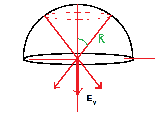

In summary, we are trying to find the electric field at the center of a charged hemispherical shell. Using spherical coordinates and the equation for electric field, we can derive the expression for the total electric field at the center. However, the given answer is different from the derived expression due to the factor of two already being taken into account in the integration over the azimuthal angle.
Titan97
450
Find Electric field at center of charged hemispherical shell
In spherical coordinates, $$dA=R^2\sin\phi d\phi d\theta$$
From the image, Enet=2dEy=2dEcosφ
$$dE=\frac{kdq}{R^2}E$$
$$dE=\frac{k\sigma dA}{R^2}$$
$$dE=\frac{k\sigma R^2\sin\phi d\phi d\theta }{R^2}$$
$$dE_{total}=2k\sigma\sin\phi\cos\phi d\phi d\theta$$
$$E=\int_0^{2\pi}\int_0^{\frac{\pi}{2}}2k\sigma\sin\phi\cos\phi d\phi d\theta$$
$$E=\frac{\sigma}{2\epsilon_0}$$
But given answer is $$E=\frac{\sigma}{4\epsilon_0}$$
The integration over the azimuthal angle from 0 to ##2\pi## already takes the factor of two in your expression ##dE_{total}=2k\sigma\sin\phi\cos\phi d\phi d\theta## into account. So you should have removed it from ##dE_{total}##.
Likes Titan97
Thank you.
