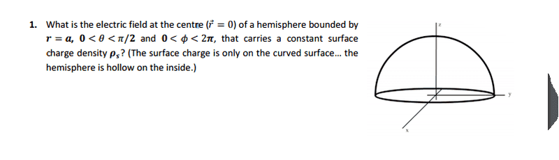

Electric field at centre of a hollow hemisphere shell.

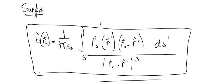

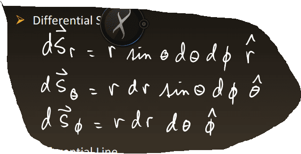

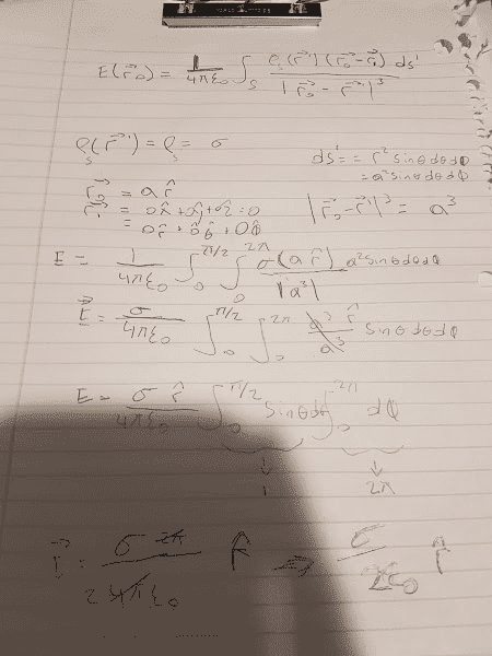

My steps for solving this was filling in the values into the formula given. Using a square differential element on the surface of the sphere, as well as spherical co-ordinates.
i'm sure i just have a small error somewhere in the math, but I'm not too sure where... I've redone the question 3 times.
These two sources, among others, show that my answer is wrong. Though I did my question differently, so i can't be sure where i went wrong.

Looks like you treated the unit vector ##\hat{r}## as a constant vector when you pulled it out of the double integral. Does the direction of ##\hat{r}## vary as you integrate over the surface? If so, you cannot treat it as a constant vector.
How would I treat the vector? My apologies. Calculus is not my strong suit.
How would I go about doing that? Calculus is not my stop suit. And also, thanks for the help.

Use symmetry to see which direction the net E field will point. Then just work with the component of E that is in that direction. (Project your integrand into that direction.)
