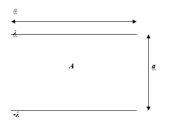

Two parallel charged wires are in vacuum. Width of wires is equal to the distance between them. Calculate electric field in the middle (point A).
Superposition
Using superposition, y components on vector E are cancelled. I get that the electric field at point A is
EA=√2 λ/(πε0a)
In my books solution, it is
EA=λ/(2ε0a)
Is my solution correct?
Note: I used integration by angle component.

What direction are you calling y? If the y direction is vertical (perpendicular to the wires), then how do you get that the y-components of E cancel?
However, I do think your answer is correct for the magnitude of the net field at A and that the book solution is incorrect. We would need to see your steps in order to check that your method is correct.
