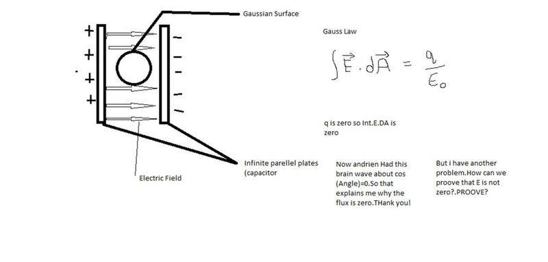

What is the electric field at a point inside a parallel plate capacitor?
I thought of this-When i place a guassian surface of ,well maybe any shape,between the parallel plates the electric field lines all pass through it,so net flux should be zero?and if it is zero E should also be zero?
But common sense tell me E can't be a zero,and something is wrong with all the above thinking.What can it be?

There are two ways I can think of to explain why the flux is zero, even if the field isn't:
1. The flux due to field lines entering the surface is equal in magnitude to the flux due to field lines. These two effects cancel each other, resulting in zero total flux.
2. You're apparently familiar with Gauss's Law. Since there is no charge enclosed by the surface, the flux must be zero for the surface -- even if the field is not zero.
Hope that helps.
Ok so you just said it.Flux is zero.That means
Integration E.dA is zero!
Area can't be zero so Electric field is zero!But that can't be?How can electric field be zero between a parrallel plate capacitor?
that is not it's meaning.notice it is a dot product so it is proportional to cosine of the angle between normal and electric field direction .on one side it is positive and on the other it is negative so flux will become zero.

At some points on the surface [itex]{E}\bullet{A}[/itex] is positive and at other points it's negative. So although E is not zero the integral still comes out zero when the positive and the negative values cancel.
Does [itex]\int_a^b f(x) =0[/itex] where [itex]b>a[/itex] imply that [itex]f(x)=0[/itex]?...Of course not, as a counterexample consider [itex]f(x)=\cos \left( \frac{\pi x}{b-a} \right)[/itex].
Similarily, [itex]\oint \mathbf{E} \cdot d\mathbf{A}=0[/itex] does not mean that [itex]\mathbf{E}[/itex] is zero.
Yes i got that gabbagabbahey and Nugatory,thanks to andrien.I got other question Please look into the pic i posted.
To prove (there is only one "o" in prove :wink:) that the electric field is not zero, you just need to calculate it. You can do so by applying Gauss' Law with a pillbox that straddles one plate, or by using Coulomb's law, or by solving Laplace's equation for the potential and then taking the negative gradient. There are many places on the internet where the calculation is shown in detail.
A relatively easy way to calculate what E is would be to apply Gauss's Law to a single, infinite plate of uniform charge density. Symmetry requires that E is the same magnitude on both sides of the plate, and points either directly toward or directly away from the plate.
After doing that, use the superposition principle to add up the fields due to two plates with opposite charge.
