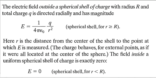

I read the following from the text
The sphere in question almost matches with above conditions. I am not sure what i am missing.
That's for a conducting sphere or shell: the charge distributes evenly over the surface.
