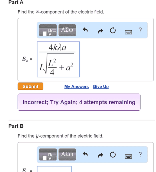

A thin rod carries a charge Q distributed uniformly over its length L , and is situated on the x-axis between x=±L/2. Find the electric field at an arbitrary point (x, y). (You will have to do separate integrals for the x and y components.)
∫dE=∫kdq/r2
[/B]
Mastering Physics is telling me that the answer does not depend on k, lambda or a, which are variables I defined.
I have another method of attempting the question which results in a nasty integration, it's basically Mastering Physics being very ambiguous in what I am allowed to define. As seen here:
Hello MW, :welcome:
A few questions to begin with: how would the program be able to understand how you defined ##a## and ##\lambda## ? Shouldn't you use ##y## and ##Q/L## instead ?
And I don't understand how you can redefine x in an x, y coordinate system ?
How does it do that ? Or is that a different program ?
Is your handwriting meant to be read by others than yourself ? I find it difficult ...
