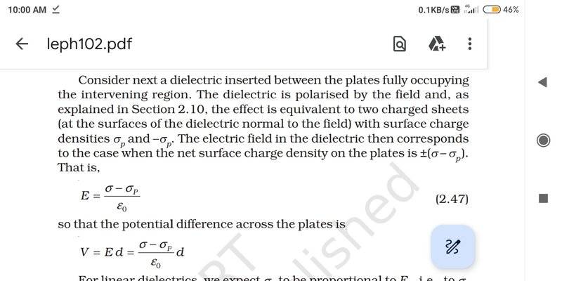

. Here i had an issue with the expression of Eind , Because we are defining it for a point inside the dielectric i felt the denominator must have a factor of K.
Later i went to the internet and referred my books , i found that everywhere it is written same way. What did i think wrong
. please explain

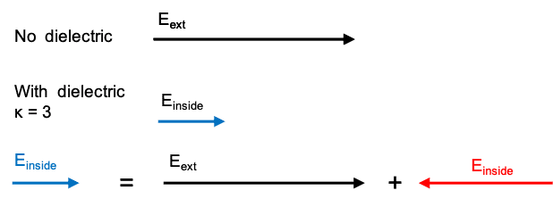

Outside the dielectric there is a uniform electric field ##~E_{\text{ext}}.##
Inside the dielectric there is a net uniform electric field ##~E_{\text{inside}}.##
The net electric field inside the dielectric is equal to the external field reduced by a factor of ##\kappa##:
##~E_{\text{inside}}=\dfrac{E_{\text{ext}}}{\kappa}.##
Why is the field inside the dielectric reduced?
Answer: Because there as induced polarization charge density on the surface of the dielectric as shown in the figure that opposes the external field. Thus the equation $$\begin{align} & E_{\text{inside}}=E_{\text{ext}}-E_{\text{ind.}} \nonumber \\ & \implies E_{\text{ind}}=E_{\text{ext}}-E_{\text{inside}}=E_{\text{ext}}-\frac{E_{\text{ext}}}{\kappa}=E_{\text{ext}}\left(1-\frac{1}{\kappa}\right)=E_{\text{ext}}\left(\frac{\kappa-1}{\kappa}\right).\nonumber \end{align}$$

The value of Eind . Observe ##~E_{\text{ind}} ##
is the field due to induced charges at a point inside the dielectric. As taught in electrostatics, permittivity of free space(epsilon not) must be multiplied by the dielectric constant. That's why they must be a k multiplied in the denominator. But it isn't. Why. I looked it up in my books also, all of them have the same way. Why is k not multiplied in the denominator?
What should the correct equation for ##~E_{\text{ind}}## be according to you?

You are confusing ##~E_{\text{inside}}## with ##~E_{\text{ind}}.## They are two different things. The black arrow in the figure is not the field inside the dielectric. It is the difference between the external field and the field inside the dielectric.

I have no control over the time zones. I explained it above with equations and I will explain it once more with vector diagrams. Look at the figure below drawn to scale.
Top: You have an external field ##~E_{\text{ext}}## which is 3 units.
Middle: You insert a dielectric of ##\kappa = 3.## The field inside the dielectric is ##E_{\text{inside}}=\dfrac{E_{\text{ext}}}{\kappa}=\dfrac{3}{3}=1~##unit.
Note that in the region of space where you used to have a field of 3 units to the right without the dielectric, you have 1 unit to the right with the dielectric. How can that be? The answer is below.
Bottom: You must have a field due to the induced charges which is 2 units to the left. The magnitude of that field is $$E_{\text{induced}}=E_{\text{ext}}\left(1-\frac{1}{\kappa}\right)=E_{\text{ext}}\left(1-\frac{1}{3}\right)=\frac{2}{3}E_{\text{ext}}=2~\text{units}.$$What's inside the dielectric is the sum of the external field from the capacitor plates plus the opposing field from the polarized charges on the dielectric surface.

sir all of that is fine my main issue here is that i m confused of the field by the induced charges. . I would have written that expression Eind =qi/(ae), if there were no dielectric. but since i m finding field for a point inside dielectric i think it must be written like qi/(kae)
(e: permittivity of free space , k dielectric constant.
