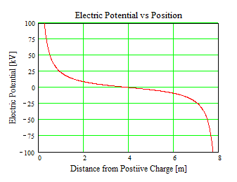

Edit: If you were to plot the electric potential vs position between the two charges you'd get a curve that looks something like this:

Need more help please
Apply the potential formula at each point using the signed charges and distances from each charge. Sum the contributions from each.
