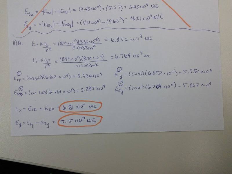

Hi jackarms! Thanks for the help but I'm still very confused. I attempted another solution, again it's wrong.. I'll post my attempt and maybe someone can give me some guidance. I'm not sure if I'm on the right track or completely off in the wrong direction.
[IMAGE REMOVED]
Thank you!
So not only did I use some wrong values in my previous calculation, after reading through my textbook further I approached it differently and got the correct answer for Part A :)
I'm not sure what to do for Part B, but am going to attempt it and post my work.
Attempted B, to find the force on q3 and it is incorrect.
Any suggestions:
All the calculations look right for both the field and the force, so I think one must be wrong. For the field, I'm not sure about the 7.15 x 107 value - are you sure that's right?
Also, an easy way to go from field to force is to just use the definition of field: [itex]E = \frac{F}{q}[/itex]
It's just nice to save some work.
Likes 1 person
Thanks for the suggestion! I used your equation and got the same result, well, almost. The force for x was the same, the force for y was 0.134 N, so I must have had an issue with my sig figs. I entered both answers and they are correct!
Thank you for your help!
