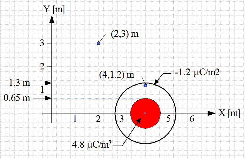

A nonconducting sphere 1.3 m in diameter with its center on the x axis at x = 4 m carries a uniform volume charge of density ρ = 4.8 µC/m3. Surrounding the sphere is a spherical shell with a diameter of 2.6 m and a uniform surface charge density σ = -1.2 µC/m2. Calculate the magnitude and direction of the electric field at the following locations.
1) x = 4m, y = 1.2m
2) x = 2m, y = 3m
Both answers are in components of i[hat] and j[hat] vectors with units of N/C.

I know that the x component of 1) is 0 because that's where the center of the sphere is at. However I'm honestly stumped on how to solve for the y component of 1) and subsequently how to solve 2) in general. As I already mentioned I tried the equations in the textbook solutions but they gave me the wrong answer and didn't explain why they used certain numbers or equations.
For 1), the electric field of the shell is 0 since the point is within the shell. I tried the equations in the textbook itself and I guess (and am absolutely confident this is wrong) the equation for the sphere's electric field is
Esphere = k*ρ*4πr4/R3 r[hat]
I have limited tries on the online homework so detailed help would be greatly appreciated. I tried reading the textbook as well as other textbooks and websites and online videos and I'm still stuck. Thanks.

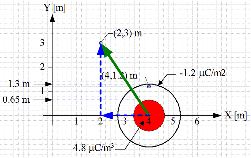

If you draw a vector from the center of the spheres to a given point, how would you find the x and y components of that vector (think right triangles)? How do you form a unit vector from a given vector?

Sure. But you are given the actual points so you have a way to determine the components directly. Here's the same image with one of the vectors drawn:
You should be able to see the vector components. Use the given point location coordinates to calculate the components.

So I got that the magnitude of the vector is approximately 3.606m at an approximate angle of 56.309°.
##\vec{r} = -3.606 \cos(56.309) \hat{i} + 3.606 \sin(56.309) \hat{j}##
Thus ##\hat{r} = -0.5547 \hat{i} + 0.83205 \hat{j}##.
Would I use that ##\hat{r}## for the equation of the sphere's electric field?
You've done a lot of extra work using trig functions. You don't need to find the angle. You have a right angle triangle whose sides ARE the components of the vector. The starting and ending points of the vector are all you need: Δx and Δy.
You use the magnitude of the actual vector in the field magnitude part of the expression, the unit vector (##\hat{r}##) just gives the directional component. Since it has unit magnitude it doesn't change the magnitude of the result.

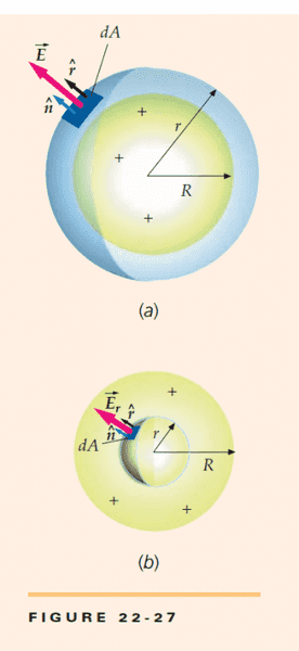

Here is a picture from my textbook that would probably illustrate what the differences between r and R are better than I could by explaining it. I used the equation of the electric field when r is less than or equal to R and set Q = ρV. Since the volume of a sphere is 4πr3, I substituted all of those things and got that really crazy equation.
When I plug in my numbers (with r = 0.65 m and R = 1.2m) I obtain 56004.61984 N/C but that doesn't seem correct.
