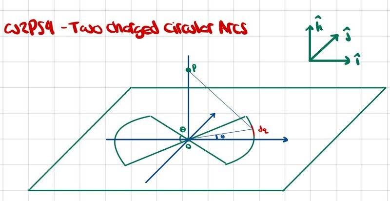

Two circular arcs of radius ##R## are uniformly charged with a positive charge per unit length ##\lambda##. The arcs lie on a plane as shown in the figure below. Each arc subtends an angle ##\theta=\frac{\pi}{3}##.
What is the direction and magnitude of the electric field anywhere along the ##z## axis that passes through the center of the circular arcs, perpendicular to the plane of the figure?
Infinitesimal electric field created by an infinitesimal charge ##dq## on the right-side arc
$$d\vec{E}_{p_r}=\frac{k_e dq}{r_{dq,p}^2}\hat{r}_{dq,p}$$
The strategy will be to figure out what ##dq##, ##\hat{r}_{dq,p}##, and ##r_{dq,p}## are, plug them into the expression for ##d\vec{E}_{p_r}##, then integrate over ##d\vec{E}_{p_r}## to obtain ##\vec{E}_{p_r}##, the electric field at ##P## due to the arc on the right.
Then I will repeat the process to calculate ##d\vec{E}_{p_l}## and ##\vec{E}_{p_l}##, for the arc on the left. The latter will be basically the same result as for ##d\vec{E}_{p_r}## but with one sign changed.
$$dq=\lambda ds = \lambda R d\theta$$
Here are the original sketch of the problem and my own sketch

I'd like to know if this solution is correct because I am following along on MIT Open Learning Library and this is a practice problem. I am allowed to submit answers, and am given a correct/incorrect feedback. For the expression above, I am getting incorrect, though I can't figure out why.
Hi @zenterix. Your integration limits should be ##-\frac {\pi}{6}## to ##+\frac {\pi}{6}## (to cover a total angle of ##\frac {\pi}{3}## for each arc).
Are you required to do the formal vector/integration method as an exercise? The problem can be solved in a few lines of basic algebra using some simple observations:
- by symmetry, the x and y components of the field at P are zero;
- the magnitude of the field at P from each charge-element (dq) is ##dE = \frac {kdq}{z^2 + R^2}##;
- the z-component of ##\vec {dE}## is ##dE cos(\phi)## where ##\phi## is the angle between the z-axis and the line from P to the charge-element.
It's a useful exercise to try as you will see how much easier/quicker the use of symmetry can make a problem.
I can't believe I missed the integral limits! My god.
I am aware of the symmetry of the problem. At this stage I am doing the full calculations to get practice doing the calculus. But I will try to just use symmetry to also get practice with identifying such shortcuts from now on as well.
Likes Steve4Physics
