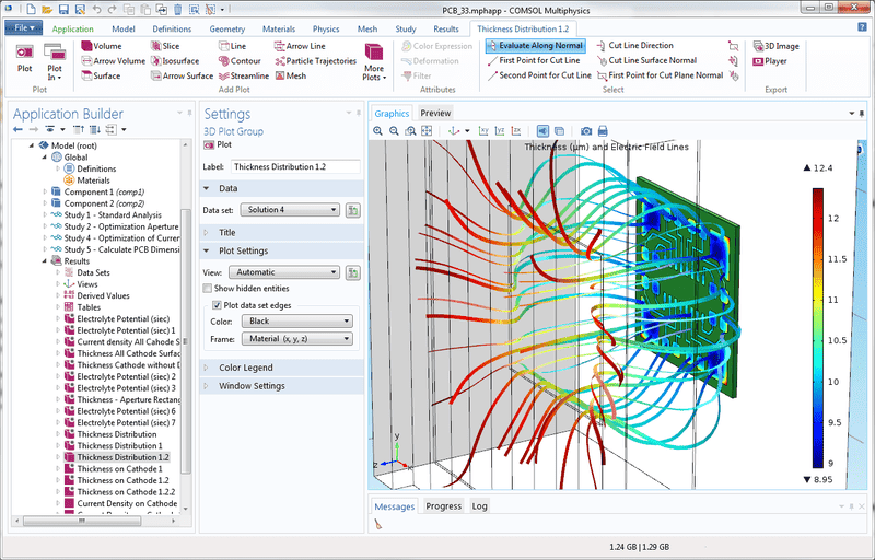

When discussing distributions of E-fields, it's usually the dielectric constant of the medium that is important, not resistivity. If you have active conduction going on, then the resistivity of the materials will matter. But unless the resistivity of the materials is fairly high, the E-fields will be kept low (it doesn't take much of an E-field to drive a current through a good conductor).
When discussing time-varying E-fields, you use the complex impedance of the medium. This can vary with time and/or with position and/or with E-field intensity. Given a complex enough geometry, you would probably model the situation with COMSOL or a similar E&M FEA software package...
https://cdn.comsol.com/products/electrodeposition/pcb_results_mph.png
Likes jim mcnamara
Also, I should add that the E-field and other quantities are generally vectors, so all of the math you would use to make these calculations will be vector-based.

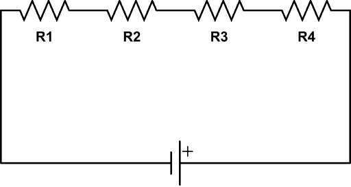

I'm not really understanding what you are asking, but I'll try this approach...
afmower said:
-Field distribution in serial medium of increasing resistance: field distribution across the 3 medium in series is equal regardless of the resistance and intensity is highest in the medium of highest resistance
Can you model this by using simple resistors and Ohm's Law for series resistors?

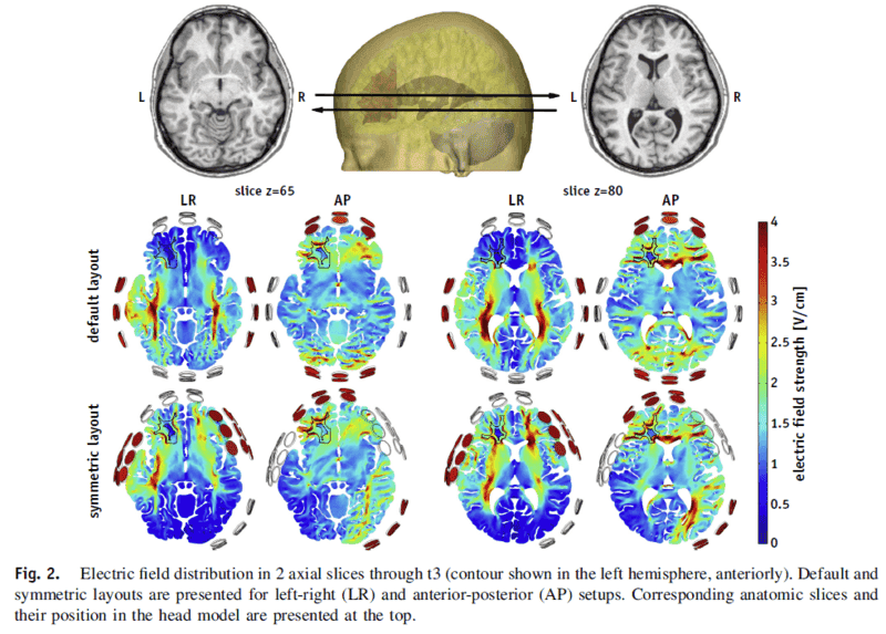

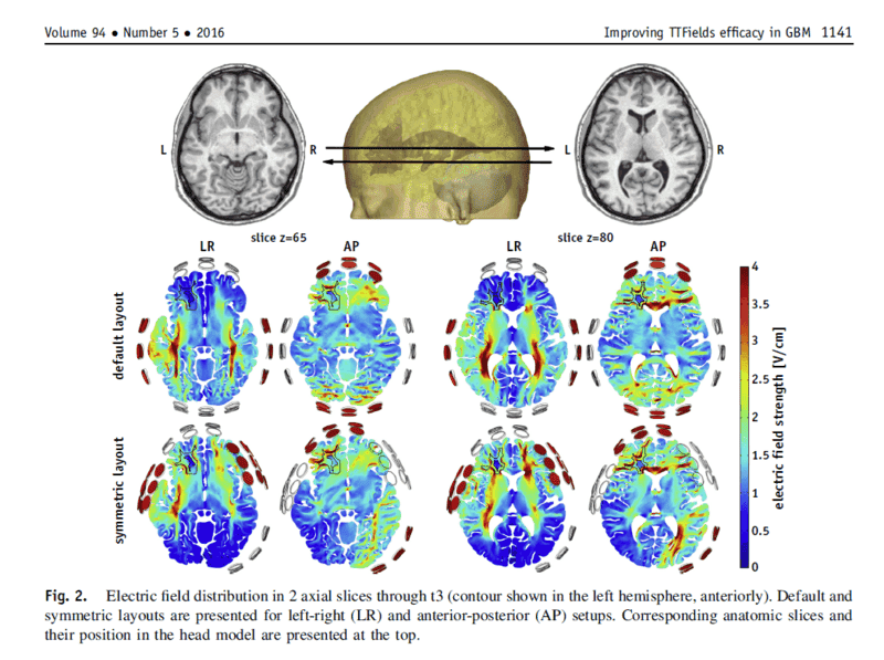

Thank you for your continued insights. Take the image below for example (t3-tumor #3). It seems that field distribution and field strength are being used interchangeably. Is it just that the figure legend should technically say electric field intensity distribution in (V/cm)? Hence what I meant by getting confused by semantics. LOL :smile:

Just to help narrow down the context, is this in regard to tomography or to localized stimulation by external fields?
If I understand what you're asking, the term "distribution" usually means a map of intensity values. The electric field has a magnitude (and direction) for every point in space. They have plotted out the magnitude of the electric field for all points in each of the axial images of the brain. This magnitude is the "strength" at any given point. Pixels that are dark red correspond to a field strength of 4 V/cm. For those that are dark blue, the value is 0 V/cm. So the magnitude of the electric field (or "strength" or "intensity") is different at any given point. Collectively the "map" of all of these different values is the "distribution."
Likes berkeman and jim mcnamara
The OPs question is in regard to an externally applied voltage to the Human brain as a treatment for glioblastoma (Brain Cancer). The image the OP supplied is from the research report here.
It is a COMSOL simulation of an array of small electrodes applied to the scalp and a 200kHz voltage is applied to selected electrodes. A field strength above 1V/cm disrupts the growth of tumor cells. The report states that there is an increase in field strength at tumor margins, but to me that was not obvious.
I think @Choppy got the 'field strength' vs 'distribution' explanation.
Likes berkeman
