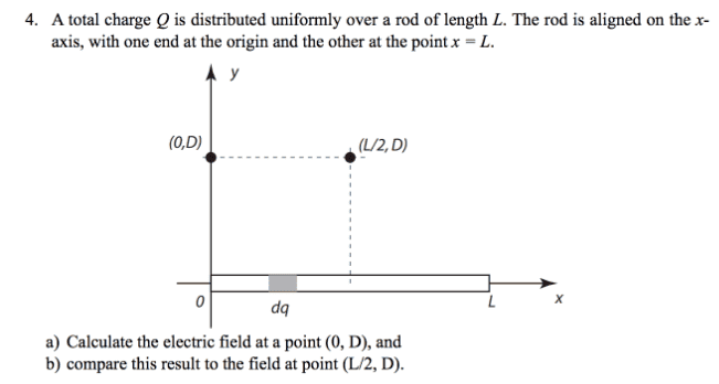

A total charge Q is distributed uniformly over rod length L. The rod is aligned on the x-axis, with one end at the origin and the other at point x=L.
a) calculate electric field at a point (0,D)
b) field at point (L/2,D)
E=Kq/r^2
q = lambda*length
I was able to find the answer to letter a. However, I deduce that for b), the answer will only be the y-component of that found in a) as the x one cancel out. However, this is not the case as the answer key shows.
Thus, I tried doing the calculations and I still arrive at the y-component found in a).

Part b is very much like part a if you consider sliding the rod halfway to the left

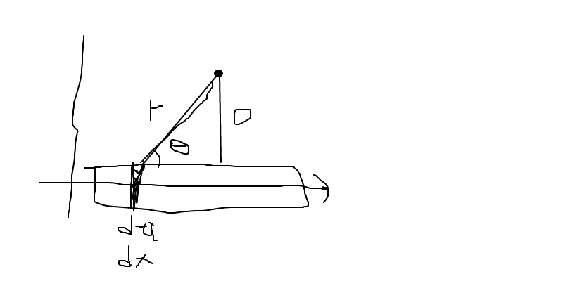

Can you explain what you used to substitute for sin(θ)? I'd expect to see a 'D' in the numerator as a result of the substitution.
Since the x-components cancel by symmetry, if you slide the rod to the left so that its center point is at the origin and half the rod is to the left of the origin and half to the right (this was suggested previously by @andrevdh) then you can take further advantage of symmetry and integrate from x = 0 to x = L/2. Just multiply the result by two.
Does the answer key solution keep the charge density as λ or does it insert Q/L for it?
Likes Jabbar

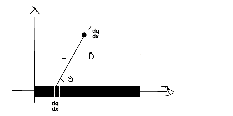

This is my theta.
For the second part, yeah I see that if I do that I can integrate quite easily from either -L/2 to L/2 or "x = 0 to x = L/2. Just multiply the result by two". Thanks for the insight.
I just don't know why what I'm doing is wrong. Moreover, why can't I say that its electric field will be equal to the y-component found in a). It feels logical to me. I'd really like to understand the concept :( .

This is clearer image to compared to what I attached previously

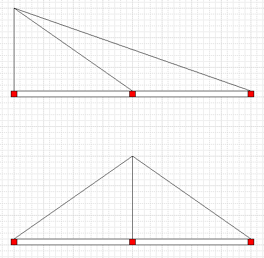

Consider that the field strength due to some dq on the rod varies inversely with the square of the distance between the point of interest and the dq. Then consider the average distance of the dq's in each case. Which case should have a larger sum of contributions?
It's going to stay the same no? As the distance the two points have to dq are the same.
Consider the two cases:
The average line distances up to the midpoint in the first case are the same as those on both sides of the point of interest in the second case. After the midpoint in the first case every distance is longer than any distance in the second case.
Oh alright, so the Electric field at that point in a) will be smaller than in b) since for dqs' on the rod... the first case will have dqs' with a greater distance r. right?
Right. More of the charge is further away.
