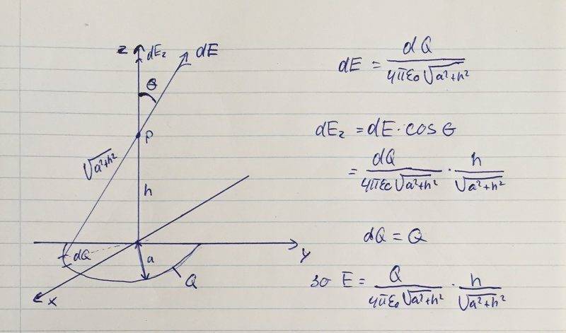

Thanks a lot for you help! However I am still confused about the direction of the electric field. So I added a drawing to clarify. I calculated the electric field in the z component but from the image is clear that this is not the only component. What geometry did I mis and how should I calculated te E field in point P? Thanks again!

It certainly does help to have a good clear image of a sketch of the situation. Here is the one you linked.
The expression you have for dE in your third line is in error. It should not have the square root. The third line should be:
##\displaystyle =\frac{dQ}{4\pi\varepsilon_0 (h^2+a^2)}\cdot\frac{h}{\sqrt{h^2+a^2}}##​
A similar problem is solved in the following thread. The choice of coordinates is different than what you have.
Electric field of a semi circle ring

You are right! I have seen that topic however that is containing a full circle where the there is only a component in the z direction.
What I have so far is the following:
\begin{align}
\vec{r}_{p}&=\vec{ha_{z}}\\
\vec{r}_{s}&=a\vec{a_{x}} cos\phi +a\vec{a_{y}} sin\phi\\
dE&=\frac{dQ(\vec{r}_{p}-\vec{r}_{s})}{4\pi \epsilon_{0}\left |\vec{r}_{p}-\vec{r}_{s} \right |^{3}}\\
dE&=\frac{dQ \, \vec{ha_{z}}-(a\vec{a_{x}}cos\phi +a\vec{a_{y}} sin\phi) } {4\pi \epsilon_{0}(a^{2}+h^{2} )^{3/2}}\\
dQ&=\rho _{L}ad\phi \\
E&=\int_{0}^{\pi}\frac{dQ \, \vec{ha_{z}}-(a\vec{a_{x}}cos\phi +a\vec{a_{y}} sin\phi) } {4\pi \epsilon_{0}(a^{2}+h^{2} )^{3/2}}d\phi\\
\end{align}$$
However I am not sure how I should integrate this in order to find the contribution in every direction?

(Actually that link IS for a semi-circle of uniform charge. )
I don't entirely understand your notation.
From what axis is angle ##\ \phi\ ## measured ?
What is meant by ##\ \vec{a_{x}},\,\vec{a_{y}},\,\vec{a_{z}}\ ## ?
Thanks for pointing me to the other topic again. That solved my question and made it clear. Again thanks for your help!
