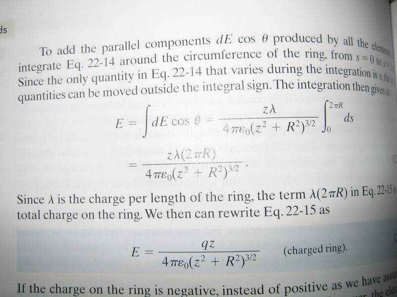

You might want to check this equation. It should be kdQ/(d^2+R^2) * cos(theta), and cos(theta)=d/sqrt(d^2+R^2). You just missed the "d". Now, apply the changes I suggested: x=d, dQ=Qdx/h, etc.
But my textbook has a different formula than that, one without cos theta. here:
So which one do I use?
In my work I replaced z with d to match the diagram, and that 1/4piepsilon = k
Oh I see, it should be d2 in the numerator?
