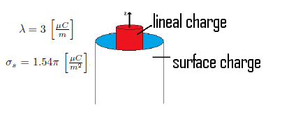

A uniform linear charge of λ is located along the z axis, and concentric circular cylinder of radius 2 [m] has a surface distribution charge of α . both distributions are infinite, the distribution of linear charge is contained in the interior of the circular cylinder as shown image.
λ = 3 * 10^-3 (C/M)
σ = 1.54pi * 10^-3 (C/M^2)
Determine E, in all regions
so i was wondering if these are the formulas that i have to use or if I am wrong
These look right, except you seem to have forgotten to cancel out the L's in the very last equation.
